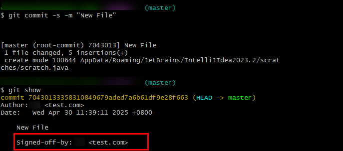

  • Git client:
    Run the following command on the local Git client to submit the change to the version control system. The commit message is New File.
git commit -s -m "New File"
You can run the git show command to check the signature result.

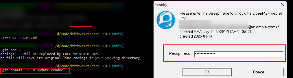

Reject commits not signed by GPG
If this option is selected, only commits signed by GPG can be pushed to the repository. For details, see Configuring a GPG Public Key.
Git client signature mode:
When committing code on the Git client, you need to add the -S parameter, indicating that the GPG (GNU Privacy Guard) signature is used to verify the identity of the committer.
git commit -s -m "your commit message"
When using tags on the Git client, you need to add the -s parameter, indicating that the GPG signature is used to verify the authenticity of the tag.
git tag -s -m "your tag message"
After this option is selected, run the following command and the commit message is update readme.
git commit -S -m "update readme"
After the command is executed successfully, you'll be instructed to enter the password of the GPG key, as shown in the following figure.

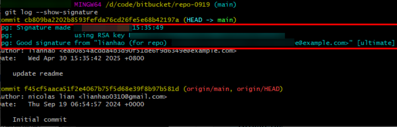

As shown in the following figure, you can run the following command to view the GPG signature submission records.

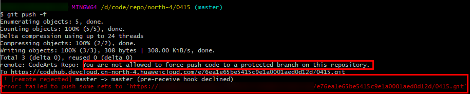

Prevent git push -f
Configure whether to use the git push -f command on the client to commit code.
It is recommended to enable this considering the git push -f command is used to push your local code repository to CodeArts Repo.
After this option is enabled, the following error message is displayed when you run the git push -f command locally:
"CodeArts Repo: You are not allowed to force push code to a protected branch on this repository."
