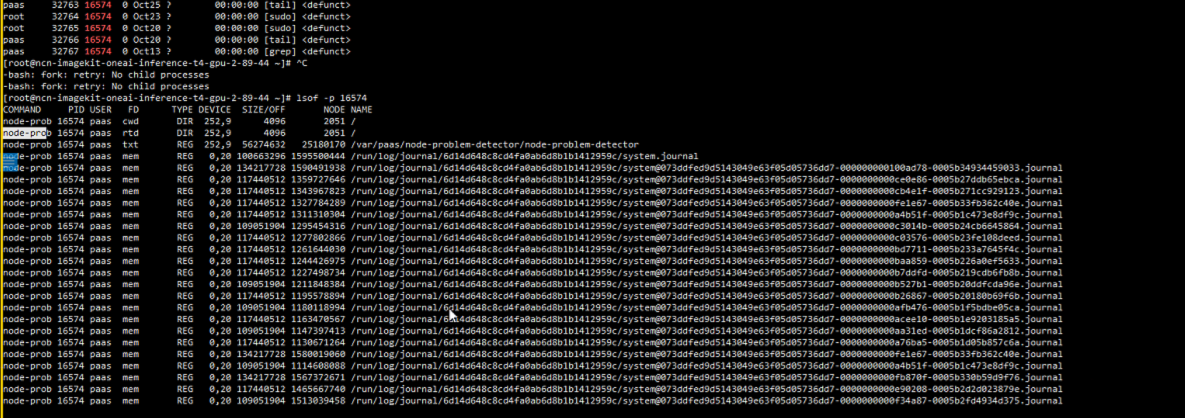

When the node load is heavy, residual CCE Node Problem Detector process resources may exist.
Symptom
After successful login to the ECS node where the CCE cluster runs, it is found that there are a large number of CCE Node Problem Detector processes exist.
Solution
Upgrade the CCE Node Problem Detector add-on to the latest version.
