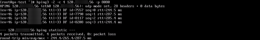

UDP
Run hping3 for testing.
- Deploy a UDP Echo service on the endpoint server. The following uses Socat as an example.
# Install Socat. yum install socat # Start Socat. nohup socat UDP-RECVFROM:<listening-port>,fork EXEC:'echo "Server response"' 2>/dev/null &
- Test the access latency before and after acceleration.
# Install hping3. yum install hping3 # Test the access latency. hping3 -2 -c <number-of-sent-packets> <IP> -p <port>;
- Compare the latency before and after the acceleration. The following uses the access from Riyadh to Beijing as an example:
- Access latency before acceleration
- Access latency after acceleration
