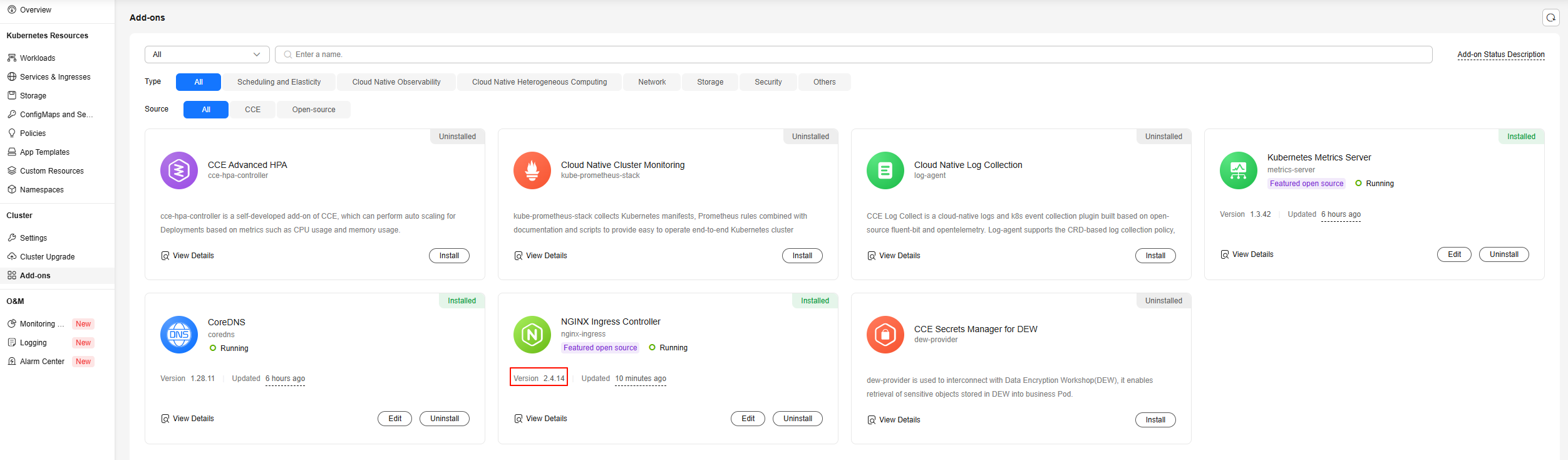

- Go to the Add-ons page and check whether the NGINX Ingress Controller add-on has been installed.
Figure 1 Viewing the installed add-on version
- If it is installed, check its version. If the add-on version is v2.4.14 or earlier, it is affected by these vulnerabilities, or the add-on is safe from these vulnerabilities.

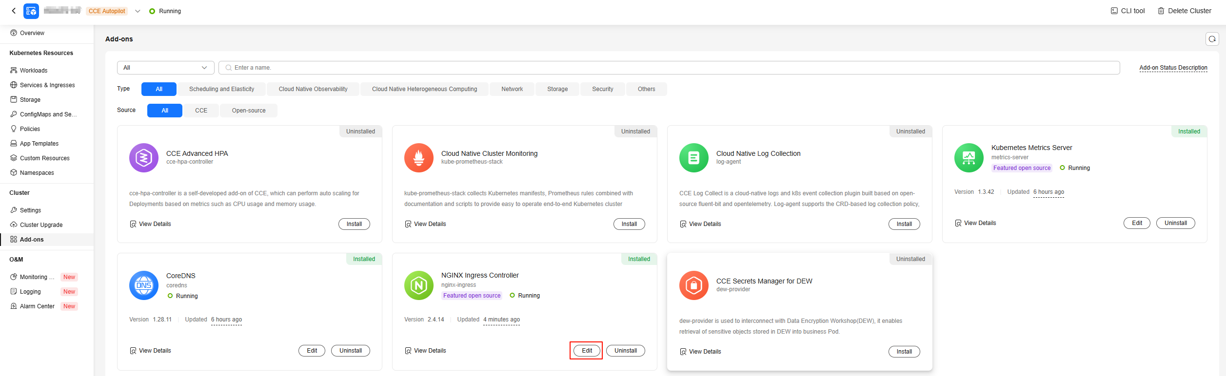

- In the navigation pane, choose Add-ons. In the right pane, find the NGINX Ingress Controller add-on and click Manage. In the window that slides out from the right, select the add-on version that is affected by the vulnerabilities and click Edit.
Figure 2 Managing the add-on

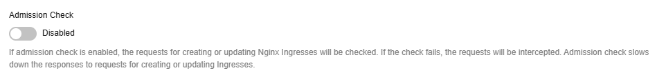

- In the Edit Add-on dialog box, disable Admission Check and click OK in the lower right corner. Wait until the add-on status changes to Normal.
Figure 3 Disabling admission check
- Upgrade NGINX Ingress Controller to the specified version with these vulnerabilities fixed. Then you can enable admission check.
Disabling admission check in NGINX Ingress Controller will bypass the pre-verification of ingress configurations, which may lead to configuration errors and affect service reliability and stability. After disabling the admission check, ensure the ingress configuration is valid when creating or updating the ingress. Verify the configuration thoroughly in a test environment before deploying it to production.

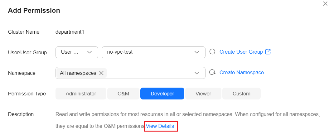

- For CVE-2025-1097, CVE-2025-1098, and CVE-2025-24514, disabling the admission check mitigates the vulnerability risk. Before fixing these vulnerabilities, grant only the permissions for creating and managing ingresses to trusted users based on the principle of least privilege. For details, see Namespace Permissions (Kubernetes RBAC-based).
- Log in to the CCE console.
- Go to the Permissions page, select the target cluster, and click Add Permission in the upper right corner.
- Specify the user or user group, namespace, and permission type to be granted, and click View Details.

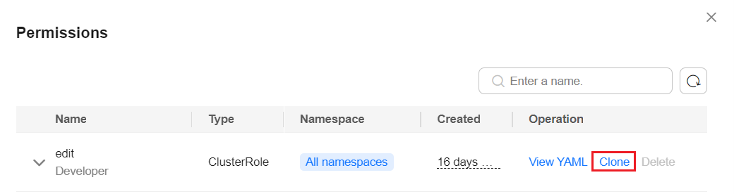

- Click Clone.

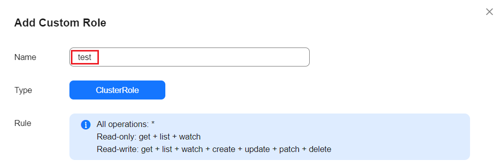

- Enter the name of the new custom permission.
- Delete the ingress role and click OK.

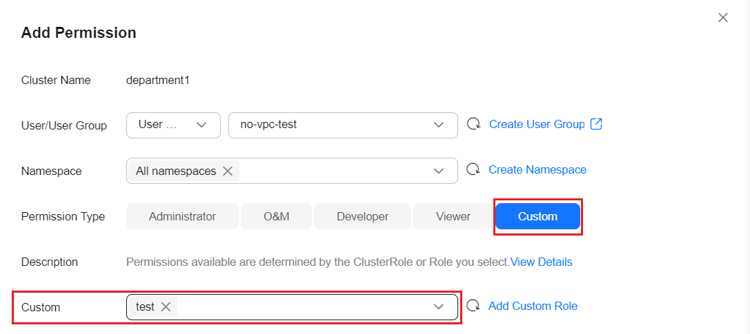

- Return back to the page for adding permissions, set Permission Type to Custom, and select the custom permission created in the previous step.
- Click OK.
