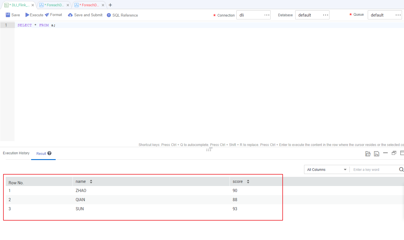

    3. Check whether the data has been inserted into the six DLI destination tables. You can create a DLI SQL script on the DataArts Factory page and run the following commands to import data into the table. You can also run the following SQL commands in the SQL editor on the DLI console.
      /* Run the following command to query the data in a table (table a is used as an example): */
      SELECT * FROM a;
      Compare the obtained data with the data in Insert data into the source data table. The inserted data meets the expectation.
      Figure 9 Destination table data
