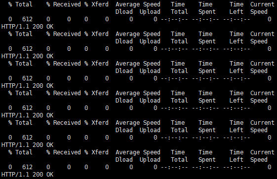

Prepare a client outside the cluster and configure the script detection_script.sh with the following content (100.85.125.90:80 indicates the public network address for accessing the Service):
#! /bin/bash for (( ; ; )) do curl -I 100.85.125.90:80 | grep "200 OK" if [ $? -ne 0 ]; then echo "response error!" exit 1 fi done

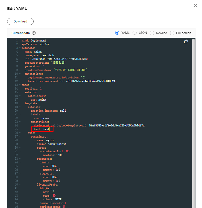

- Run the script bash detection_script.sh. Log in to the CCI 2.0 console. In the navigation pane, choose Workloads. On the Deployments tab, select the target workload and click Edit YAML to trigger a rolling upgrade.
If the access to the application is not interrupted and the returned responses are all 200 OK, a graceful upgrade is performed.
