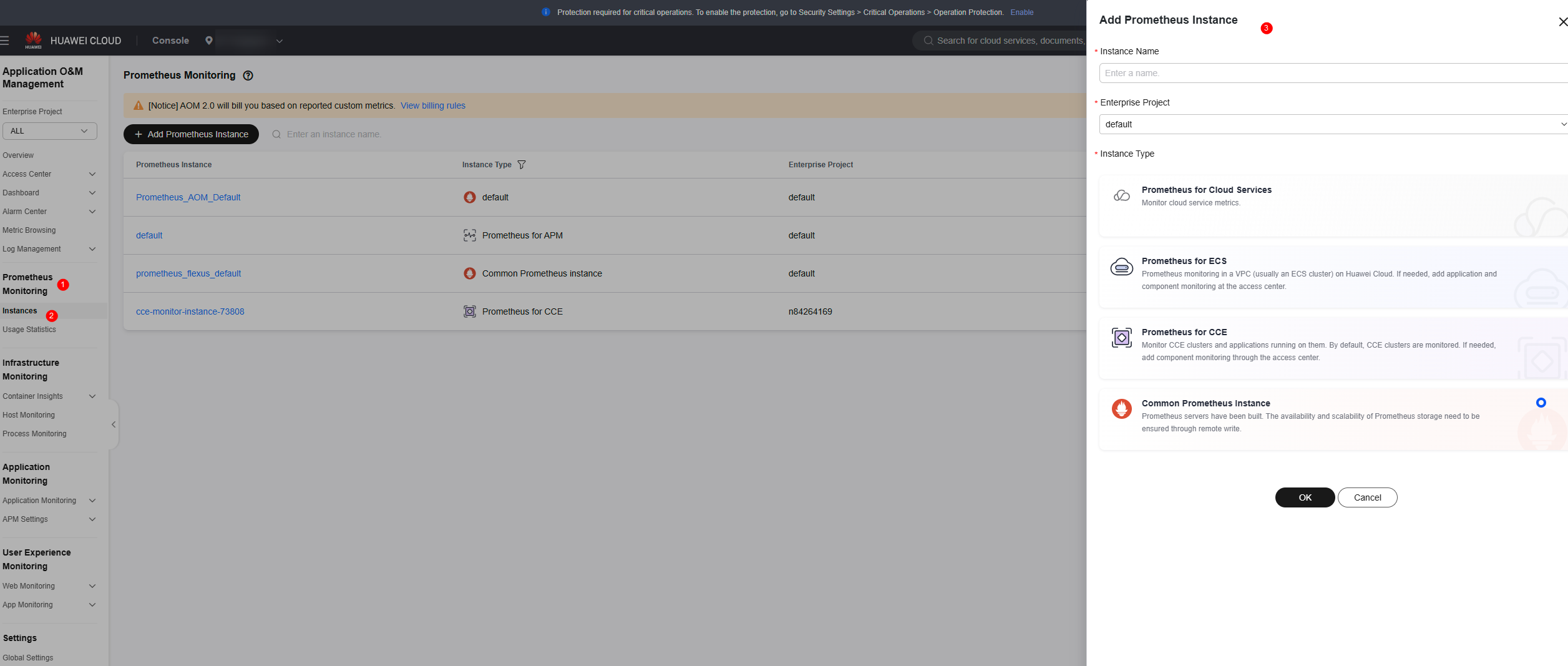

- In the navigation pane on the left, choose Metric Browsing > Prometheus Monitoring. On the displayed page, click Add Prometheus Instance.
- Set the instance name, enterprise project, and instance type.
If the CCE Cloud Bursting Engine for CCI add-on is being used or required, the CCE cluster also needs this Prometheus instance, with the instance type set to Prometheus for CCE.
- Click OK.

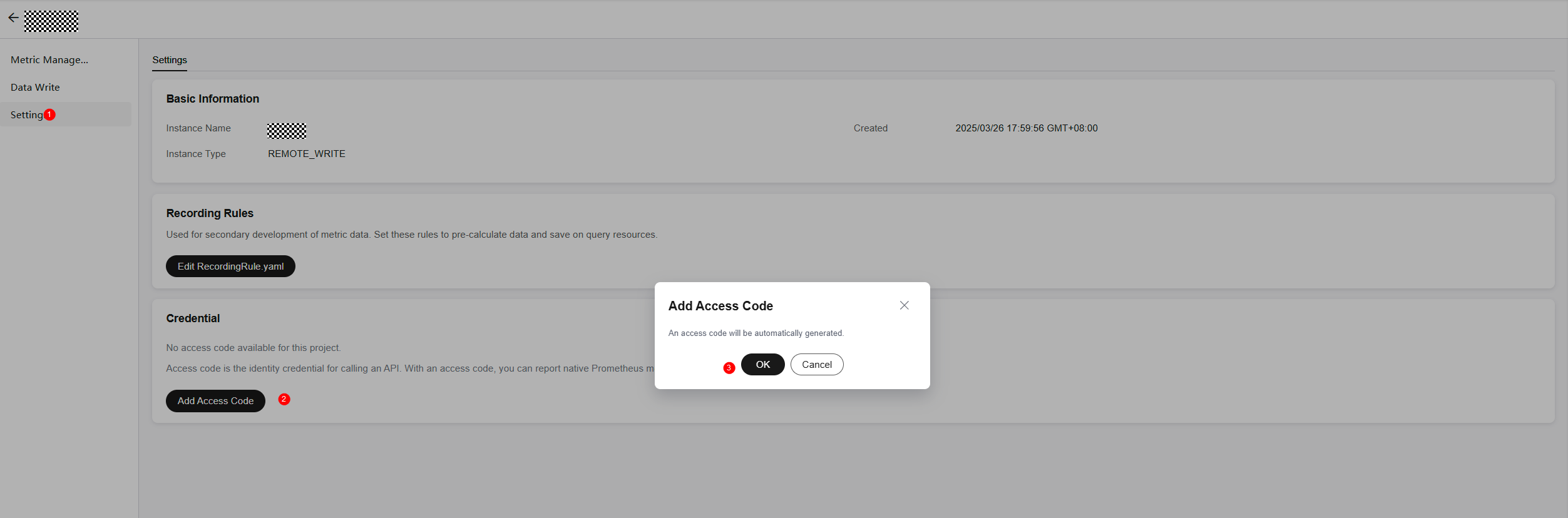

- Click the name of the created Prometheus instance.
- In the navigation pane, choose Settings. In the Credential area, click Add Access Code.
- Click OK.

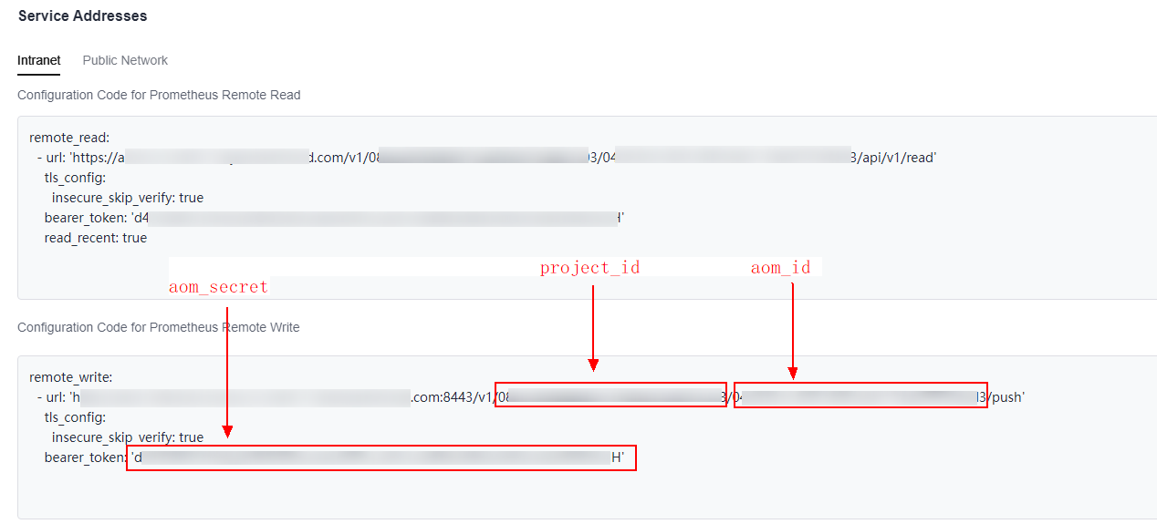

- Obtain the values of <project_id>, <aom_id>, and <aom_secret>.
- Combine the obtained values into a character string in the format of <project_id>_<aom_id>: <aom_secret>.

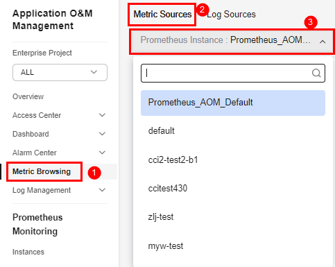

- Log in to the AOM 2.0 console.
- In the navigation pane, choose Metric Analysis > Metric Browsing.
- On the Metric Sources tab, select the Prometheus instance created in Step 1: Create a Prometheus Instance.
