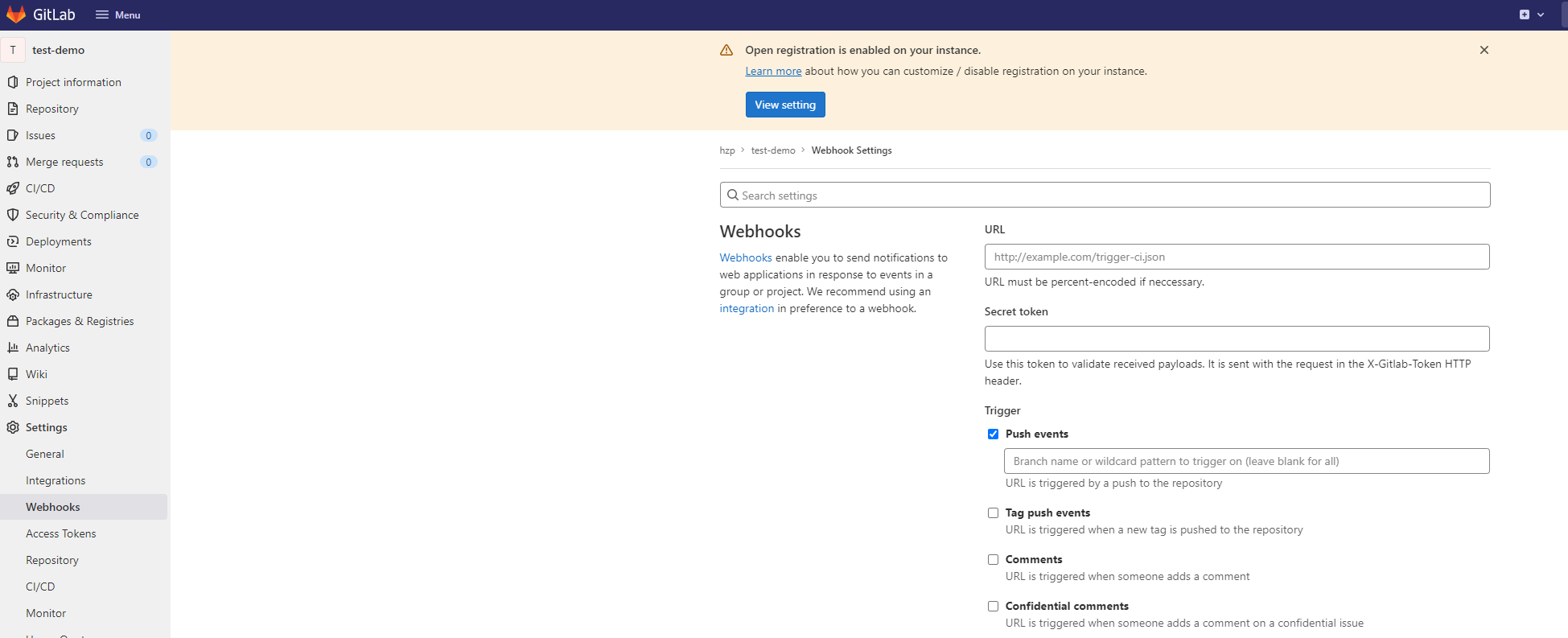

  2. Configure GitLab webhook.
    1. Log in to GitLab and go to the code repository. In this example, the repository name is test-demo.
    2. Choose Settings > Webhooks, and set URL and Secret token to the GitLab webhook URL and secret token obtained in 1.
      Figure 1 Webhooks configuration

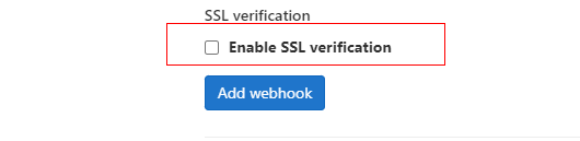

    3. Deselect Enable SSL verification for SSL verification and click Add webhook.
      Figure 2 Configuration completed
