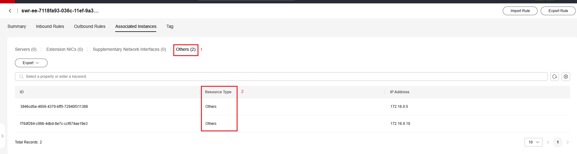

- Removing an instance from a security group will affect the network communications of the instance. If the associated instance in the security group is displayed on the Others tab (as shown in part 1), you need to go to the target instance console to perform operations.
If Resource Type is Others (as shown in part 2), the resource type is unknown. In this case, check the resources by referring to How Do I Know the Instances Associated with a Security Group?
