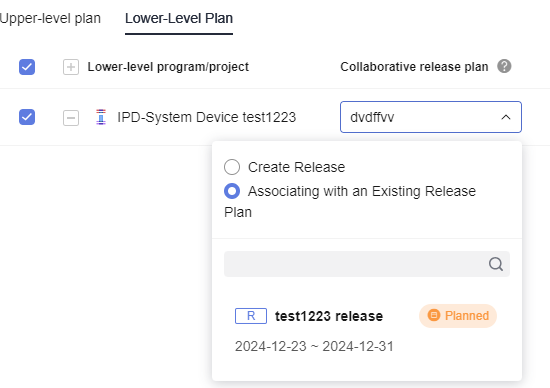

If plan collaboration is required, click
in the Operation column and select Plan Collaboration. The page is displayed. Select the release plan to be synchronized. - If you click Next, the Lower-Level Plan tab for plan collaboration is displayed. The Lower-Level Plan page displays all lower-level nodes of the program to which the current release belongs. By default, the nodes are displayed in a tree structure. The lower-level nodes are selected by default. The release name and start/end time of the previous step are carried. The owner is the product manager of each project by default. If there is no product manager, the owner is the project administrator. You can also select members of the project node from the drop-down list. You can also deselect child items. Deselected child items cannot be executed. If you deselect all child items and click OK, a release without collaboration is created.
- Collaborative release plan: The release name, start time, and end time set in the previous step are used by default. You can also select Create Release or Associating with an Existing Release Plan from the drop-down list.
- If the release name is the same as an existing release name of the program or project, the name of the collaborative release plan is highlighted, a message is displayed, and OK cannot be clicked.
- If the release is not completed and is not coordinated by other upper-level plans, the owner, start time, and end time of the selected release cannot be modified.
- Copying configuration: Click
in the Operation column to copy the collaborative release name, start time, and end time of the row to all rows. This operation cannot be performed if you select an existing release.
- After you click OK, the message indicating that the release is successful is displayed. If the collaboration fails, the failure cause page is displayed, showing the collaboration plan result list and failure cause.
