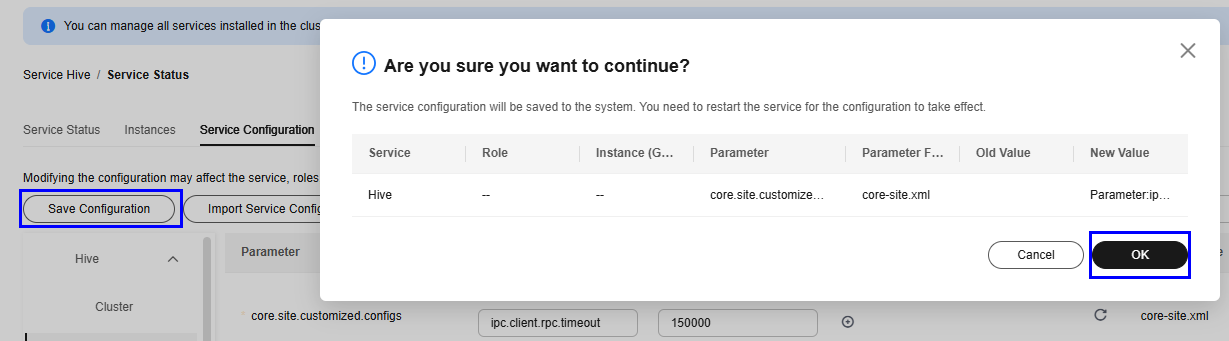

Task Example: Adding Custom Hive Parameters
Hive depends on HDFS. By default, Hive accesses the HDFS client. The configuration parameters to take effect are controlled by HDFS in a unified manner.
For example, the HDFS parameter ipc.client.rpc.timeout affects the RPC timeout period for all clients to connect to the HDFS server. If you need to modify the timeout period for Hive to connect to HDFS, you can use the configuration customization function. After this parameter is added to the core-site.xml file of Hive, this parameter can be identified by the Hive service and its configuration overwrites the parameter configuration in HDFS.
  1. Log in to the MRS console.
  2. On the Active Clusters page, select a running cluster and click its name to switch to the cluster details page.
  3. On the MRS cluster details page, click Components.
  4. Choose Hive > Service Configuration.
  5. In the configuration type drop-down box on the right side, switch Basic to All.
  6. In the navigation tree on the left, select Customization for the Hive service. The system displays the customized service parameters supported by Hive.
  7. In core-site.xml, locate the row that contains the core.site.customized.configs parameter, enter ipc.client.rpc.timeout in the Parameter column, and enter a new value in the Value column, for example, 150000. The unit is millisecond.
    Figure 4 Configuring custom Hive parameters
  8. Click Save Configuration and operate as prompted.
    Figure 5 Saving custom configurations
