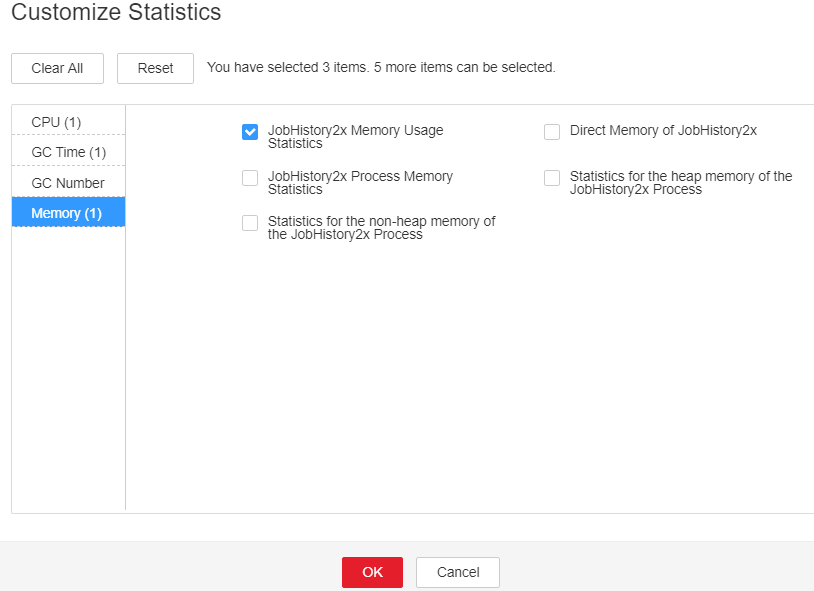

- On the FusionInsight Manager portal, choose Cluster > Services > Spark2x > Instance and click the JobHistory2x for which the alarm is generated to go to the Dashboard page. Click the drop-down menu in the Chart area and choose Customize > Memory > JobHistory2x Memory Usage Statistics from the drop-down list box in the upper right corner and click OK. Check whether the used heap memory of the JobHistory2x Process reaches the threshold (default value is 95%) of the maximum heap memory specified for JobHistory2x. Figure 1 JobHistory2x Memory Usage Statistics
- On the FusionInsight Manager home page, choose Cluster > Services > Spark2x > Instance. Click JobHistory2x by which the alarm is reported to go to the Dashboard page, click the drop-down list in the upper right corner of the chart area, choose Customize > Memory > Statistics for the heap memory of the JobHistory2x Process, and click OK. Based on the alarm generation time, check the values of the used heap memory of the JobHistory2x process in the corresponding period and obtain the maximum value. Figure 2 Statistics for the heap memory of the JobHistory2x Process
