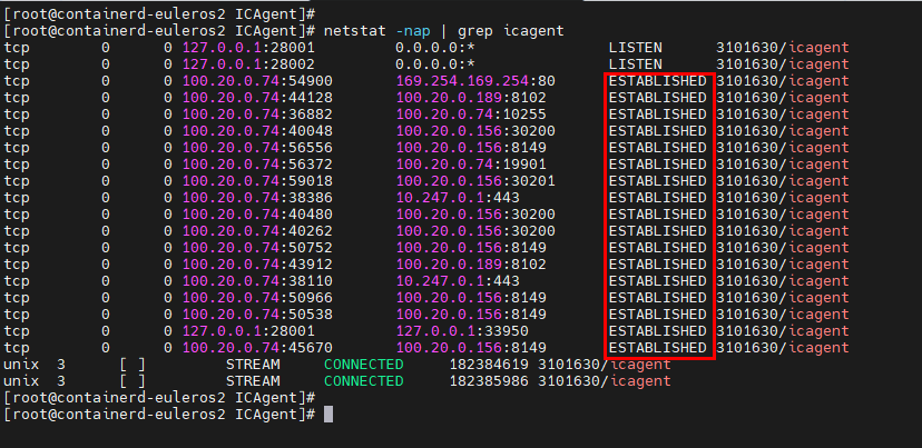

    2. Run the netstat -nap | grep icagent command to check whether the network connection status of the ICAgent process is ESTABLISHED. If yes, the network connection is normal.
      Check whether the connection status of ports 30200 and 30201 on the server is ESTABLISHED. If not, check whether these ports are allowed in the security group.
