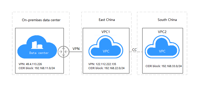

Figure 1 Using VPN together with Cloud Connect
- Subnet of your on-premises data center: 192.168.11.0/24; VPN gateway IP address: 49.4.113.226
- VPC1 subnet: 192.168.22.0/24; VPN gateway address: 122.112.222.135
- VPC2 subnet: 192.168.33.0/24

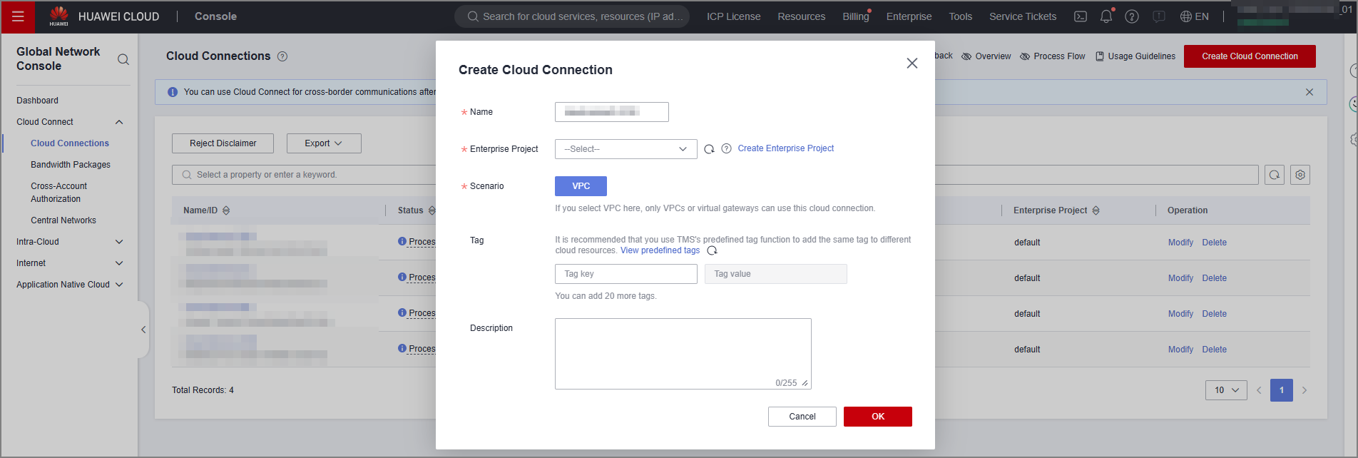

- Create a cloud connection.
- Log in to the console. Click Service List in the upper left corner. Under Networking, select Cloud Connect. In the navigation pane on the left, choose Cloud Connections. On the displayed page, click Create Cloud Connection in the upper right corner.
- Configure required parameters and click OK.
Figure 2 Create Cloud Connection
You can create a cloud connection in any region where the VPC is located. If you have two VPCs in the same region, you can use a VPC peering connection (with a lower latency) or a cloud connection to connect the two VPCs. If you have more than two VPCs, use cloud connections to connect them.

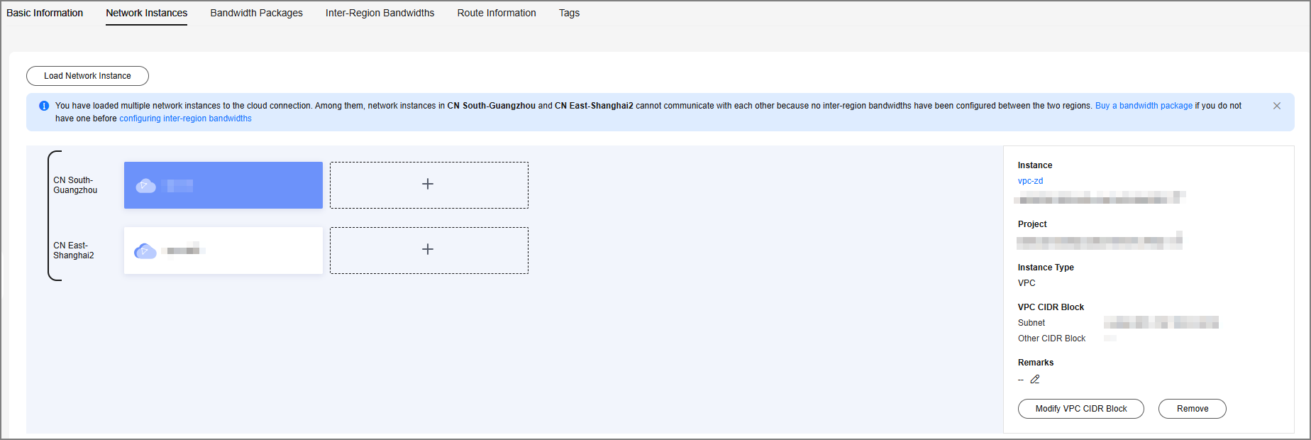

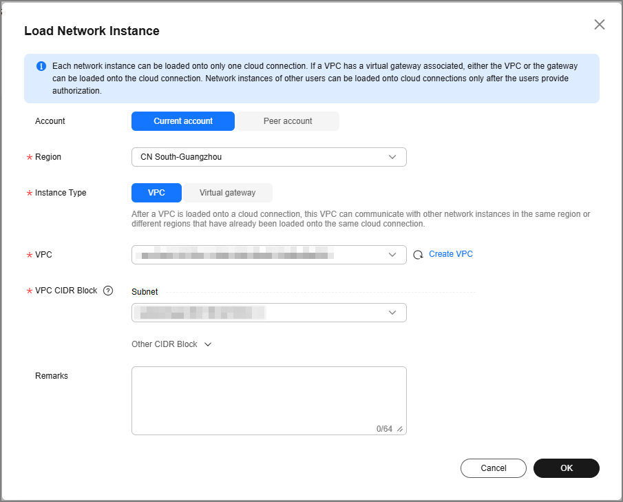

- Select the Network Instances tab and click Load Network Instance.
Configure required parameters and click OK.Figure 3 Loading network instance 1
- Select CN South-Guangzhou for Region. Select VPC2. You can select some or all subnets for Subnet. You can also add VPC subnets by customizing CIDR blocks.
Add VPC1 in the CN East-Shanghai1 region and add its network configuration.
Figure 4 Loading network instance 2
- A cloud connection can be created using the same account or different accounts. If you want to create a cross-account connection, obtain authorization first.

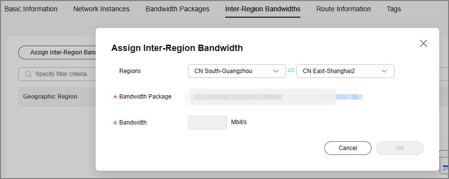

- Click the Inter-Region Bandwidths tab, and click Configure Inter-Region Bandwidth. If there are multiple regions, allocate the total bandwidth of the cloud connection among multiple regions based on the bandwidth usage in each region. In this example, the bandwidth is used for interconnection between two regions.

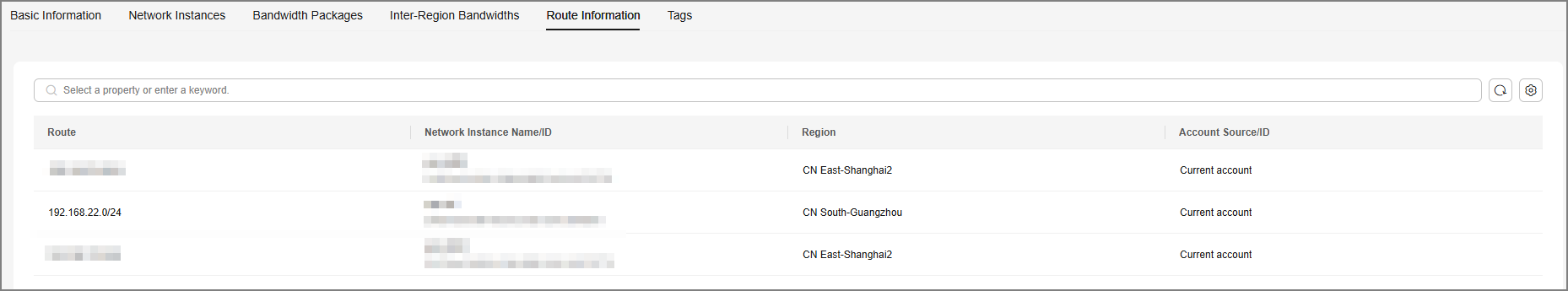

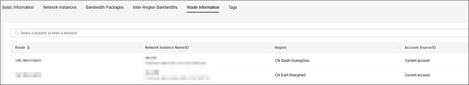

- To verify the route information, select the Route Information tab.
Route information for interconnection between regions is displayed. The subnets in the route are the subnets that are interconnected through the cloud connection. At this time, the subnets of VPC1 and VPC2 can access each other.Figure 6 Verifying the route information

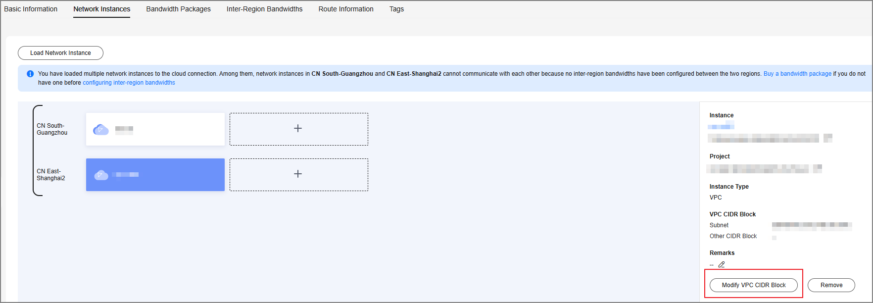

- Modify VPC CIDR blocks.
When you configure a network instance for the cloud connection between VPC1 and VPC2, the subnet connected to VPN is also considered to be connected to VPC1. Therefore, you need to modify the network instance of VPC1.
- Click the cloud connection name to go to the cloud connection details page.
- On the Network Instances tab page, select a network instance in the CN East-Shanghai2 region.
- Click Modify VPC CIDR Block on the right of the page.
Figure 7 Modifying the VPC CIDR block

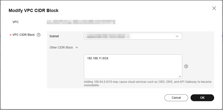

- For Other CIDR Block in the Advanced Settings area, enter the CIDR block to which VPC1 connects through the VPN connection and click OK.
Figure 8 Modifying the VPC CIDR block

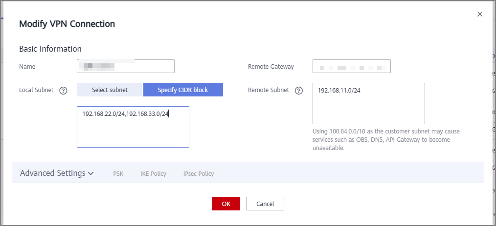

- Choose Virtual Private Network > Classic, locate the VPN connection created for VPC1, and choose More > Modify in the Operation column.
- On the Modify VPN Connection page, select Specify CIDR block for Local Subnet and enter the subnets of VPC1 and VPC2. Use a comma (,) to separate the two subnets. Keep the remote subnet and other information unchanged.
Figure 10 Modifying the VPN connection

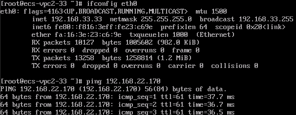

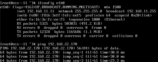

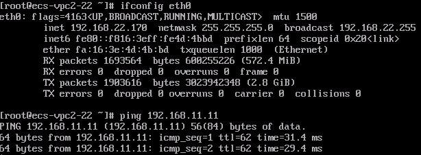

In this environment, the user data center, VPC1, and VPC2 each has three ECSs deployed. The IP addresses of the three ECSs are 192.168.11.11, 192.168.22.170, and 192.168.33.33, respectively. ECS1 (192.168.11.11) can communicate with ECS2 (192.168.22.170) through VPN. ECS3 (192.168.33.33) cannot communicate with other two ECSs. After a cloud connection is established, ECS3 can communicate with ECS2 but cannot communicate with ECS1.
After updating the VPC CIDRs and VPN configurations, ECS1, ECS2, and ECS3 can communicate with each other.
- On-premises data center
ECS1 can access ECS2 in the VPC1 subnet through the VPN connection.
ECS1 can access ECS3 in the VPC2 subnet.
- VPC1 on Huawei Cloud
ECS2 in the VPC1 subnet can access ECS1 in the subnet of your on-premises data center.
ECS2 in the VPC1 subnet can access ECS3 in the VPC2 subnet.
