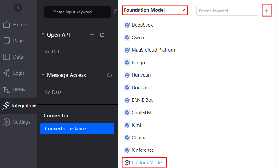

- In the application designer, choose Integrations > Connector > Connector Instance.

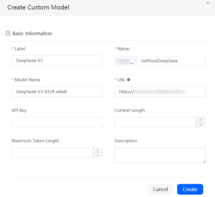

- Choose Foundation Model > Custom Model and click +. The page for creating a custom foundation model connector is displayed. Figure 3 Creating a custom foundation model connector
- Enter and save the configuration information of the foundation model connector. Figure 4 Setting foundation model connector information

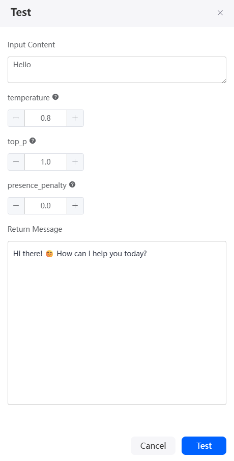

- Test the connectivity of the foundation model connector.
- On the custom foundation model details page, click Test. On the displayed dialog box, click Test. The foundation model connector test page is displayed.
- In the Input Content text box, enter the dialog content (for example, "Hello"), and click Test. Check whether the returned message is correct. If the returned message contains the streaming response packet, the foundation model connector is configured successfully. Otherwise, check whether the foundation model connector information is correct.Figure 5 Foundation model connector test page

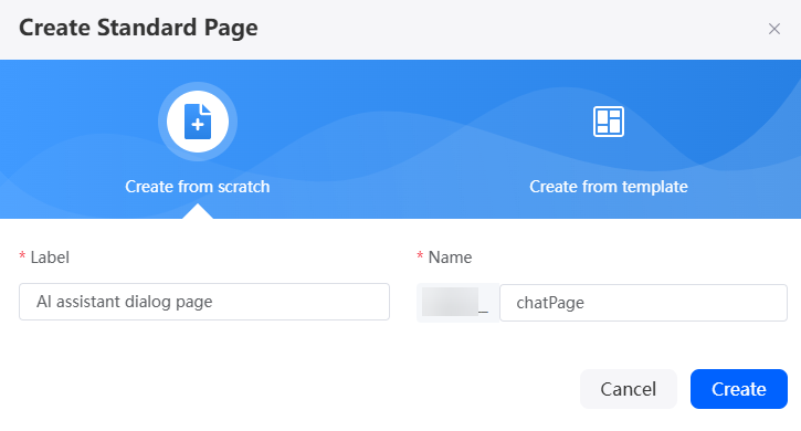

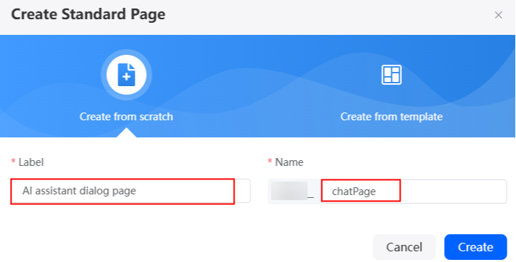

- Click
next to the page, set the basic information about the standard page, and click Create. Figure 6 Creating a standard page

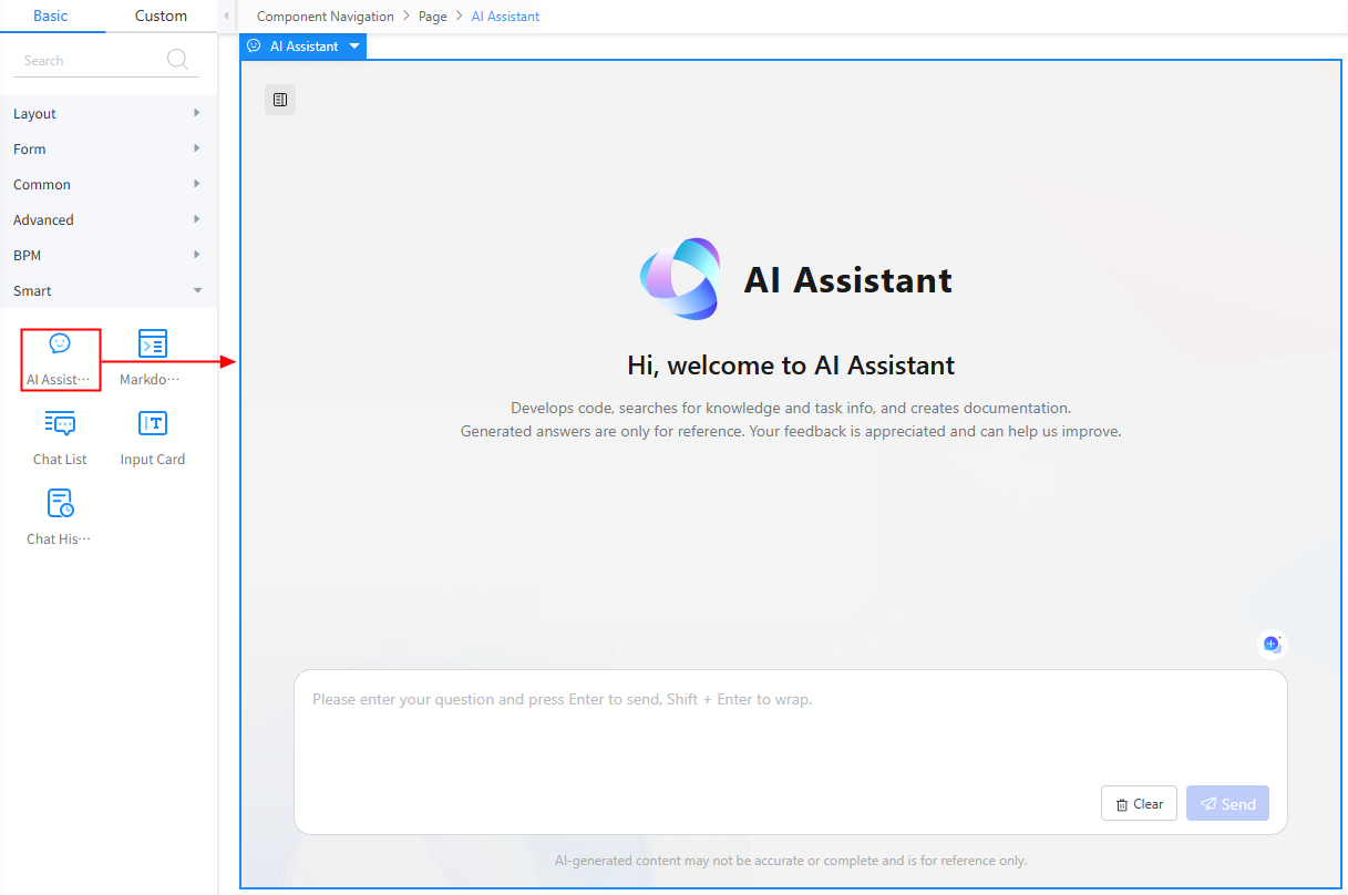

- Drag the AI Assistant widget from Basic > Smart to the canvas. Figure 7 Dragging the AI Assistant widget to the page

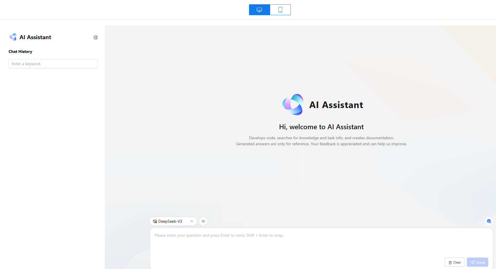

- On the saved standard page, click
. The preview page is displayed. Figure 9 Preview page of the AI assistant
- In the AI assistant chat box, type something like "How is the weather today?" and click Send.
If the AI assistant returns the corresponding streaming result, the AI assistant widget is successfully connected to the external foundation model API.
