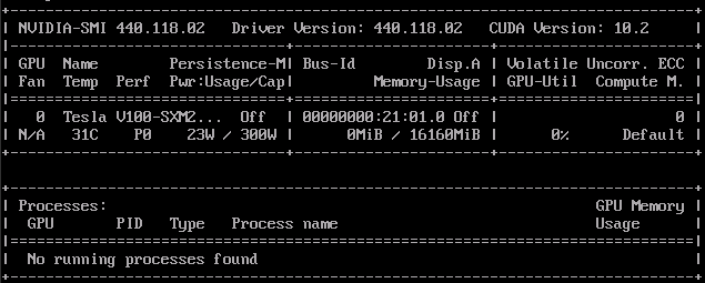

Verifying the Add-on
After the add-on is installed, run the nvidia-smi command on the GPU node and the container that schedules GPU resources to verify the availability of the GPU device and driver.
  • GPU node:
    • If the add-on version is earlier than 2.0.0, run the following command:
      cd /opt/cloud/cce/nvidia/bin && ./nvidia-smi
    • If the add-on version is 2.0.0 or later, run the following command:
      cd /usr/local/nvidia/bin && ./nvidia-smi
  • Container:
    • If the cluster version is v1.27 or earlier, run the following command:
    • If the cluster version is v1.28 or later, run the following command:
      cd /usr/bin && ./nvidia-smi
If GPU information is returned, the device is available and the add-on has been installed.
