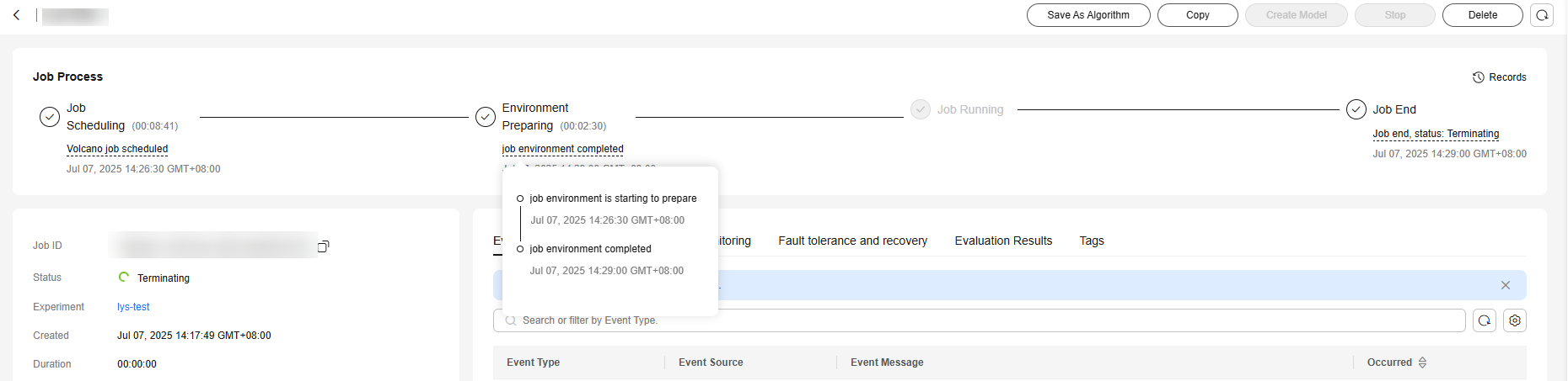

On the top of the training job details page, the training job module of ModelArts Standard displays the job process details. There are four main phases: Job Scheduling, Environment Preparing, Job Running, and Job End.
You can check the subphases of each main phase.
- Job Scheduling logs all job activities, including successful or failed creations, scheduled jobs, and their exact timestamps.
- Environment Preparing documents essential steps for preparing the environment. It includes starting the setup, checking initial conditions, downloading training code, and completing the process, along with timestamps.
- Job Running tracks job details, including start and end times for each training step.
- Job End captures essential details like the date and time of the job's outcome.
Click Records in the upper right corner of the job process to see all its activity logs. This allows you to track details like repeated preemptions, rescheduling, or restarts during the job's execution.
