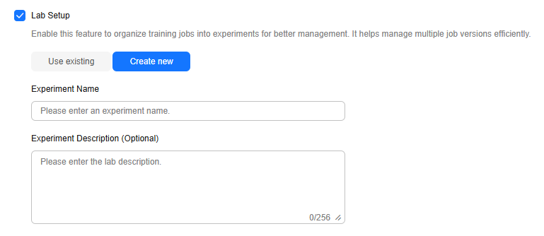

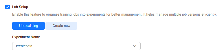

To add a training job to an experiment, configure Experiment when creating a training job. The options are as follows:
  • Create new: An experiment can only be created when you create a training job. If you select this option, enter a new experiment name. After the job is submitted, the experiment is created and the job is added to the new experiment. The experiment name will be checked. If the name is already in use, the job cannot be submitted.
  • Use existing: Select an existing experiment from the drop-down list box to add the job to the existing experiment.

Creating a Job to Be Added to an Experiment
Log in to the ModelArts console, choose Model Training > Training Jobs, and click Create Training Job in the upper right corner.
On this page, set Experiment to Create new and enter a name for the new experiment. Then, an experiment is created after you create the training job.
Figure 1 Creating a training job
Adding a Created Job to an Experiment
Log in to the ModelArts console, choose Model Training > Training Jobs, and click Copy in the Operation column of the target job. Alternatively, click the job name or ID in the job list. On the job details page, click Copy in the upper right corner.
  • For a job that has not been added to an experiment, set Experiment to Create new and enter a name for the new experiment. Then, an experiment is created after you copy the training job.
  • For a job that has been added to an experiment, set Experiment to Use existing and select the target experiment.
    Figure 2 Copying a training job

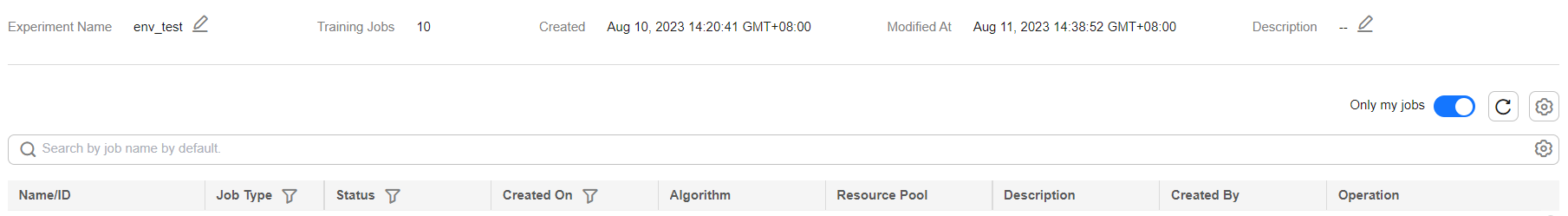

Viewing Experiment Details
In the experiment list, click an experiment name to go to the experiment details page. Basic experiment information is displayed in the upper part of the experiment details page, and the job list of the experiment is displayed in the lower part of the experiment details page.
Figure 3 Viewing experiment details
  • You can click to edit the name and description of an experiment.
  • You can click Only my jobs to view the jobs that you have created and included in the experiment.
    By default, if an account has multiple IAM users, only the jobs of the current IAM user are displayed.
  • You can search for jobs by name, ID, algorithm, status, creation time, job type, or resource pool.
  • You can refresh the job list. You can click the refresh button in the upper right corner of the job list to refresh it.
  • You can click the setting button in the upper right corner of the job list to select items you want to display in the job list.
