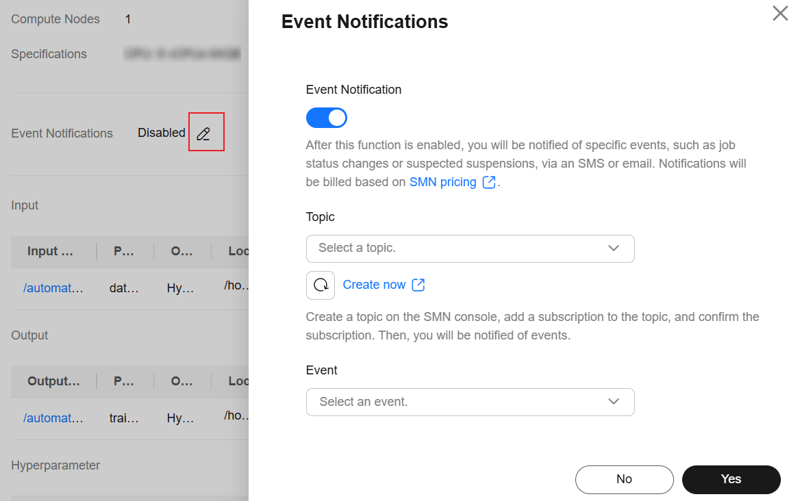

  5. On the training details page, manage event notifications of the training job.
    • Event notifications cannot be configured for training jobs in the Completed, Failed, Abnormal, or Terminated state.
    • To set up event notifications, you need permission to view jobs.
    • Only the updated training status is notified for modification events.
    After event notification is enabled, you will be notified of a specific event, such as a job status change or suspected suspension, through an SMS message or email. Notifications will be billed based on SMN pricing. For details, see Billing.
    • If event notification has been enabled for a training job, you can click next to Enabled to modify or disable event notification.
      Figure 1 Modifying event notification
    • If event notification has not been enabled for a training job, you can click next to Disabled to enable event notification.
      Figure 2 Configuring event notification
    Table 3 Event notification parameters
    Parameter
    Description
    Topic
    Topic name of event notification. You can select a topic from the drop-down list or click Create now to create a topic on the SMN console.
    NOTE:
    You can create a topic on the SMN console, add a subscription to it, and confirm the subscription status. Once these steps are completed, you will be notified of the event.
    Event
    Select events you want to subscribe to. Examples: JobStarted, JobCompleted, JobFailed, JobTerminated, and JobHanged.
    NOTE:
    Only training jobs using GPUs or NPUs support JobHanged events.
