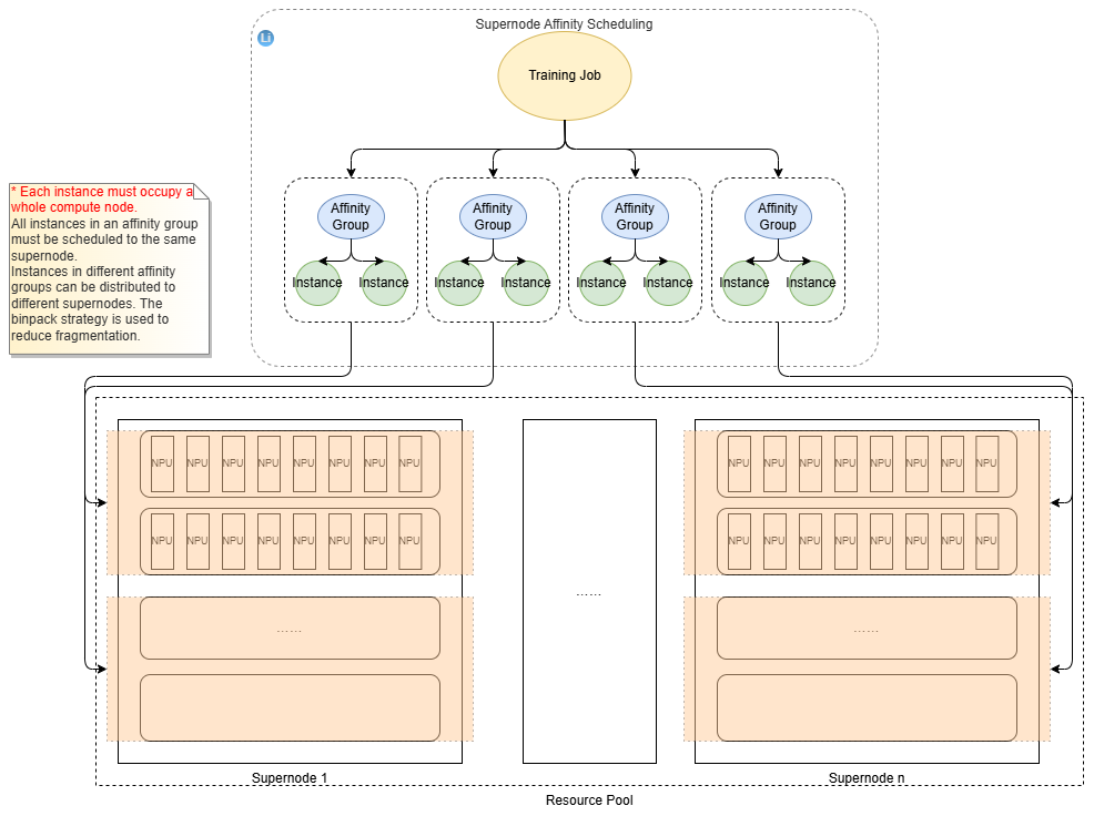

The figure shows that each task in a training job is referred to as an instance. ModelArts uses affinity groups to schedule training jobs on supernodes and maximize their ultra-high bandwidth. An affinity group is a group of instances that you want to connect through a hyperplane in a training job. Instances in the same affinity group run on the same supernode.
Figure 1 Training job orchestration
To boost training efficiency, place PUs that need high bandwidth in the same affinity group.

Figure 2 Supernode affinity scheduling for a training job
If the training job needs eight instances, with Supernode Affinity Group Instances set to 2. Here are the available resources:
  • Resource pool A
    Supernode 1: maximum nodes: 8; available nodes: 6
    Supernode 2: maximum nodes: 8; available nodes: 2
  • Resource pool B
    Supernode 3: maximum nodes: 8; available nodes: 7
    Supernode 4: maximum nodes: 8; available nodes: 1
Both pools have eight available nodes, meeting the first condition. However, supernode 3 in pool B can allocate three affinity groups, while supernode 4 can allocate none. The second condition is not met. Thus, only pool A can run the training job. If the job goes to pool B, it will wait in the queue due to insufficient resources.
