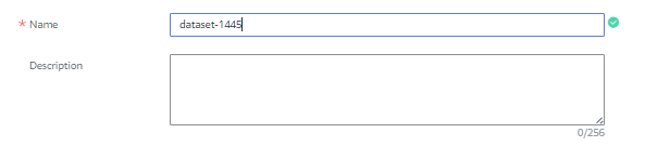

- Click Create. On the Create Dataset page, create a dataset based on the data type and data labeling requirements.
- Set the basic information, the name and description of the dataset.

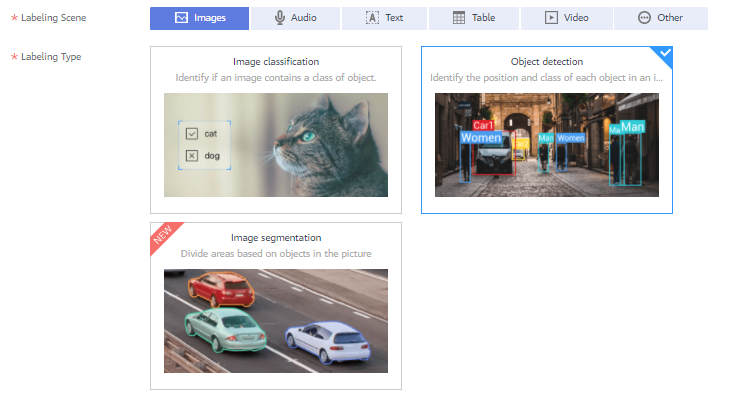

- Set labeling scene and type. In this example, choose Images and Object detection.
Figure 2 Dataset labeling scene and type

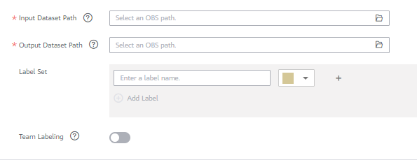

- Select an OBS path as Input Dataset Path, and select another OBS path as Output Dataset Path.
Figure 3 Input and output dataset path

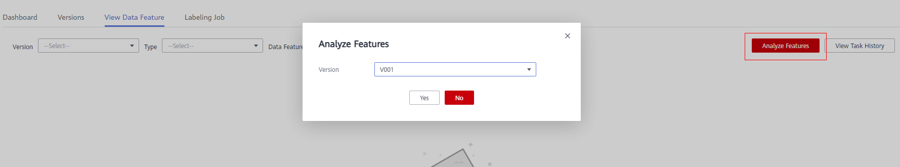

- Create a feature analysis task.
- Before performing feature analysis, publish a dataset version. On the dataset Dashboard page, click Publish in the upper right corner to publish a new version of the dataset.
- After the version is published, go to the Dashboard page. Click View Data Feature and Feature Analysis. In the displayed dialog box, select the newly published dataset version and click OK to start feature analysis.
Figure 4 Starting feature analysis

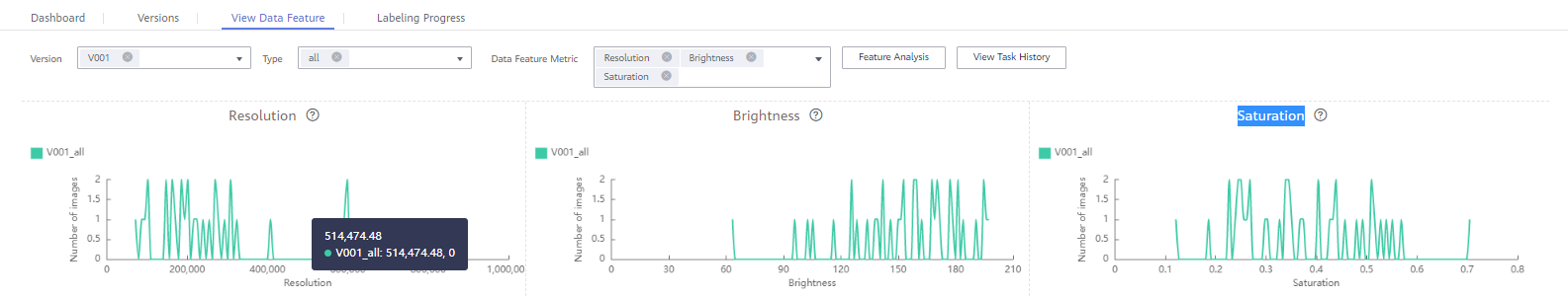

- View feature analysis results.
After feature analysis is complete, you can select Version, Type, and Data Feature Metric on the View Data Feature tab page. Then, the selected versions and metrics are displayed on the page. The displayed chart helps you understand data distribution for a better understanding of your data.
- Version: Select one or more versions for comparison.
- Type: Select types to be analyzed. The values all, train, eval, and inference are available for you to select. They indicate all, training, evaluation, and inference, respectively.
- Data Feature Metric: Select the metrics to be displayed. For details about the metrics, see Data feature metrics.
Figure 6 Viewing feature analysis resultsIn feature analysis results, for example, image brightness distribution is uneven, which means images of a certain brightness are lacking. This greatly affects model training. In this case, increase images of that brightness to make data more even for subsequent model building.

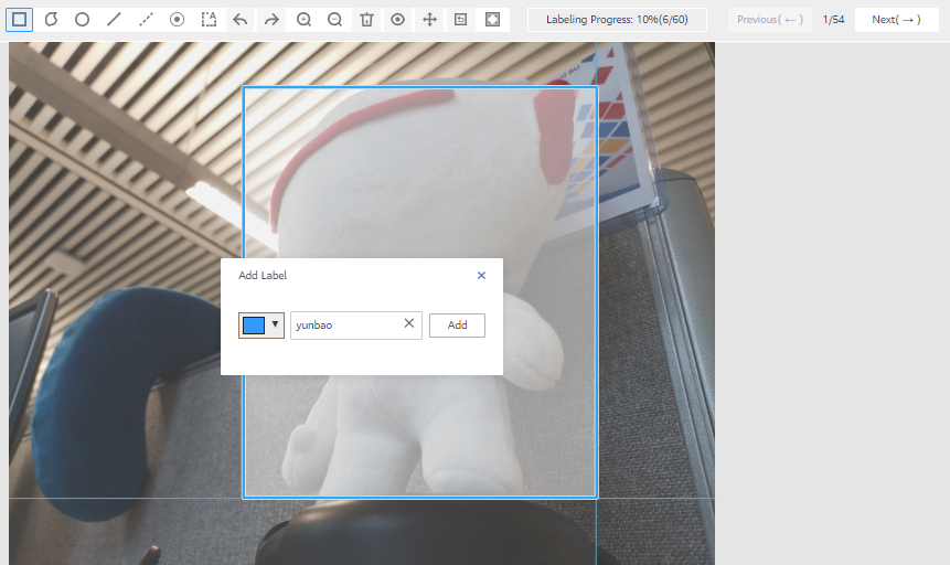

- On the Unlabeled tab page, click an image. The system automatically directs you to the page for labeling the image.
- On the toolbar of the labeling page, select a proper labeling tool. In this example, a rectangle is used for labeling.
Figure 7 Labeling tools
- Drag the mouse to select an object, enter a new label name in the displayed text box. If labels already exist, select one from the drop-down list box. Click Add.
Figure 8 Adding an object detection label
- Click Back to Data Labeling Preview in the upper left part of the page to view the labeling information. In the dialog box that is displayed, click Yes to save the labeling settings. The selected image is automatically moved to the Labeled tab page. On the Unlabeled and All tab pages, the labeling information is updated along with the labeling process, including the added label names and the number of images for each label.

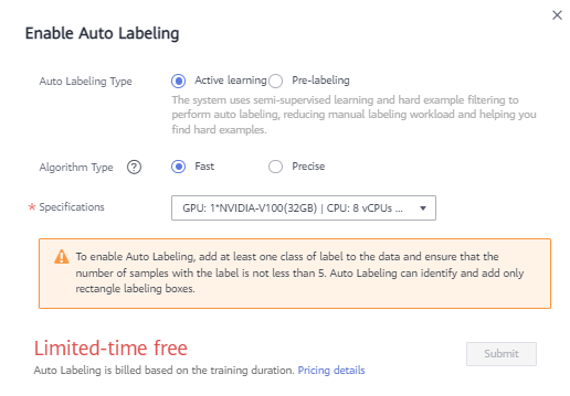

- Auto labeling
Auto labeling allows you to automatically label remaining data after a small amount of data is manually labeled.
- On the dataset details page, click Auto Label in the upper right corner.
- In the Enable Auto Labeling dialog box, set the following parameters and click Submit.
- Auto Labeling Type: Active learning
- Algorithm Type: Fast
Retain the default values of other parameters.

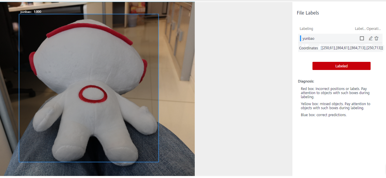

Figure 10 Viewing auto labeling progress - Confirm auto labeling results.
After auto labeling is complete, click the image on the To be confirmed tab page. On the labeling details page, you can view or modify the auto labeling result.
For correct labeling, click Labeled on the right. For wrong labeling, correct wrong labels. For auto labeling of object detection datasets, confirm images one by one. Ensure that all images are confirmed and go to the next step.
Figure 11 Confirming auto labeling results

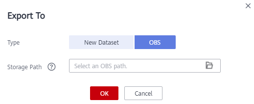

- Export data to OBS.
- On the dataset details page, select or filter the data to be exported, and click Export in the upper right corner.
- Set Type to OBS, enter related information, and click OK.
Storage Path: path where the data to be exported is stored. You are advised not to save data to the input or output path of the current dataset.
Figure 12 Exporting to OBS - After the data is exported, view it in the specified path.

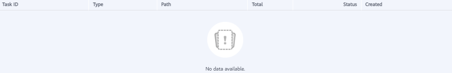

- View task history.
After exporting data, you can view the export task details in Export History.
- On the dataset details page, click Export History in the upper right corner.
- In the View Task History dialog box, view the export task history of the current dataset. You can view the task ID, creation time, export type, export path, total number of exported samples, and export status.
