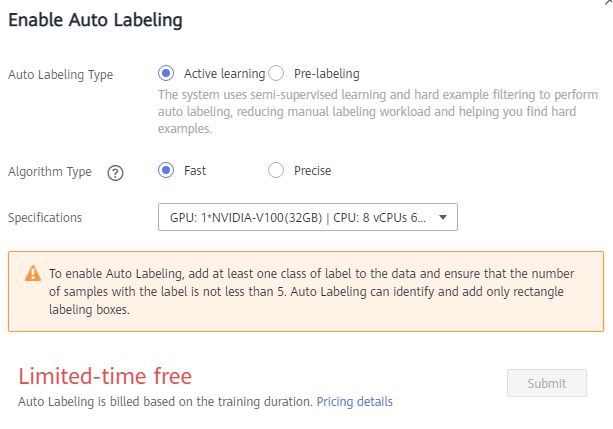

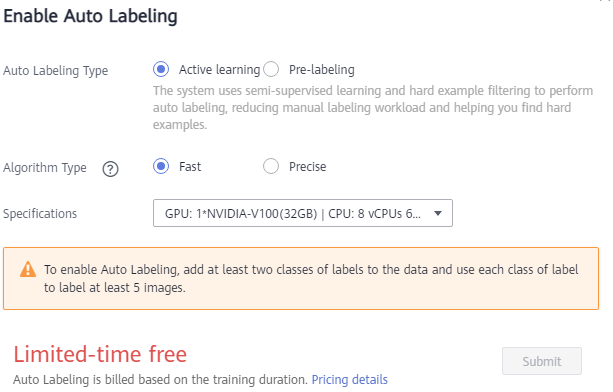

- On the Enable Auto Labeling page, select Active learning or Pre-labeling. For details, see Table 1 and Table 2.
Table 1 Active learning Parameter
Description
Auto Labeling Type
Active learning: The system uses semi-supervised learning and hard example filtering to perform auto labeling, reducing manual labeling workload and helping you find hard examples.
Algorithm Type
For a dataset of the image classification type, set the following parameters:
Fast: Use the labeled samples for training.
Precise: Use labeled and unlabeled samples for semi-supervised training, which improves the model precision.
Specifications
Resource specifications used by an auto labeling job.
NOTE:Creating an auto labeling job is free, but you will be billed for OBS storage based on usage. For details, see Product Pricing Details. To avoid wasting resources, clear your OBS bucket after labeling jobs and their subsequent tasks are complete.
Compute Nodes
The default value is 1, indicating the single-node system mode. Only this parameter value is supported.

For labeling jobs of the object detection type, only rectangular boxes can be recognized and labeled when Active learning is selected.
Figure 1 Enabling auto labeling (image classification)Figure 2 Enabling auto labeling (object detection)Figure 3 Enabling auto labeling (pre-labeling) - After setting the parameters, click Submit to enable auto labeling.

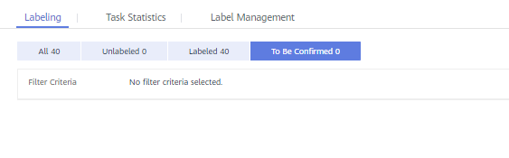

- In the labeling job list, click a labeling job name to go to the labeling job details page.
- Click the To Be Confirmed tab to view the auto labeling progress.
You can also enable auto labeling or view the auto labeling history on this tab page.
Figure 4 Labeling progressIf there are too many auto labeling jobs, they may have to wait in a queue due to limited free resources. This means that they will stay in the labeling state until their turn comes. To ensure that your labeling job can run properly, you are advised to avoid peak hours.
