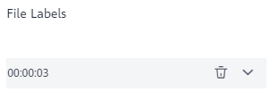

Click Label List in the upper right corner of the page. The time points when the video is labeled are displayed.
Figure 2 File labels - Click Back to Data Labeling Preview in the upper left corner of the page. The labeling job details page is displayed, and the labeled video file is displayed in the Labeled tab.
