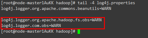

  3. Run the following command:
    tail -4 log4j.properties
    If the command output shown in Figure 1 is displayed, the log level is successfully changed.
    Figure 1 Adding an OBS log level

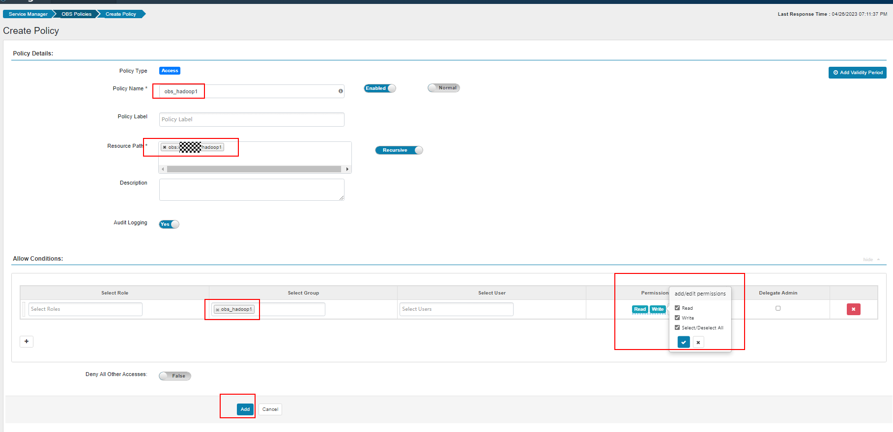

  3. Log in to the Ranger management page as the rangeradmin user.
  4. On the home page, click component plug-in name OBS in the EXTERNAL AUTHORIZATION area.
  5. Click Add New Policy and add the Read and Write permissions on the desired OBS paths to the user group created in Step 1.
    The following figure shows the configurations needed for adding the Read and Write permissions on obs://OBS parallel file system name/hadoop1 to user group obs_hadoop1.
    Figure 2 Granting the new user group permissions for reading and writing OBS paths
