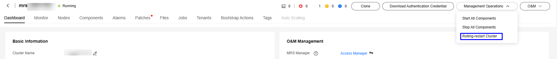

- Log in to the MRS console.
 - Choose Active Clusters and click a cluster name to go to the cluster details page.
 - In the upper right corner of the page, choose Management Operations > Perform Rolling Cluster Restart.
      Figure 1 Performing rolling cluster restart
       - The Rolling-restart Cluster page is displayed. Select Only restart instances whose configurations have expired and click OK to perform rolling restart for the target cluster.
 - After the rolling restart task is complete, click Finish.

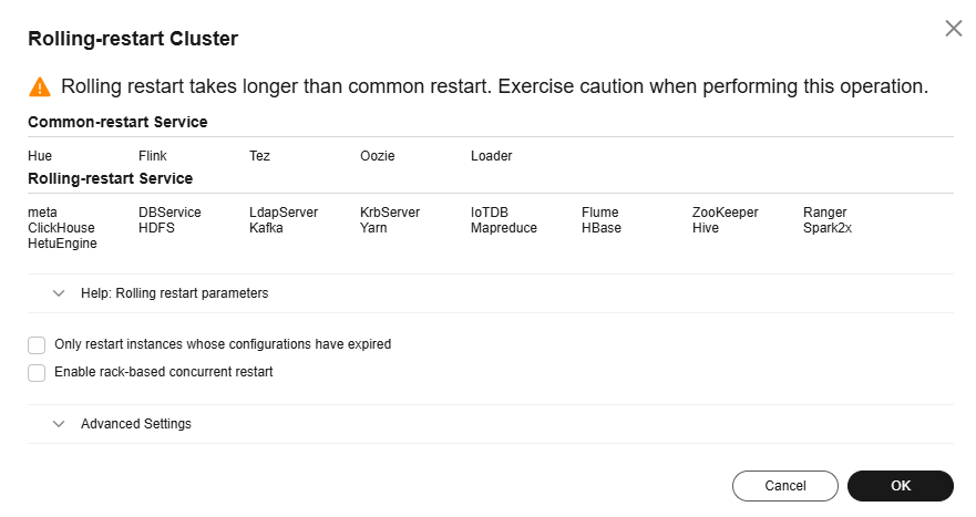

 - In the displayed dialog box, enter the password of the current login user and click OK.
 - If you select the rolling restart, adjust related parameters based on the site requirements.
      Figure 2 Rolling restart
      Table 1 Rolling restart parameters Parameter
Example Value
Description
Restart only instances with expired configurations in the cluster
Whether to restart only the modified instances in a cluster.
Enable rack strategy
Whether to enable the concurrent rack rolling restart strategy. This parameter takes effect only for roles that meet the rack rolling restart strategy. (The roles support rack awareness, and instances of the roles belong to two or more racks.)
This parameter is available only when a rolling restart is performed on HDFS or YARN.
Data Nodes to Be Batch Restarted
Number of instances that are restarted in each batch when the batch rolling restart strategy is used. The default value is 1.
- This parameter is valid only when the batch rolling restart strategy is used and the instance type is DataNode.
 - This parameter is invalid when the rack strategy is enabled. In this case, the cluster uses the maximum number of instances (20 by default) configured in the rack strategy as the maximum number of instances that are concurrently restarted in a rack.
 - This parameter is configurable only when a rolling restart is performed on HDFS, HBase, YARN, Kafka, Storm, or Flume.
 - This parameter for the RegionServer of HBase cannot be manually configured. Instead, it is automatically adjusted based on the number of RegionServer nodes. Specifically, if the number of RegionServer nodes is less than 30, the parameter value is 1. If the number is greater than or equal to 30 and less than 300, the parameter value is 2. If the number is greater than or equal to 300, the parameter value is 1% of the number (rounded-down).
Batch Interval
0
Interval between two batches of instances to be roll-restarted. The default value is 0.
Decommissioning Timeout Interval
1800
Decommissioning interval for role instances during a rolling restart. The default value is 1800s.
Some roles (such as HiveServer and JDBCServer) stop providing services before the rolling restart. Stopped instances cannot be connected to new clients. Existing connections will be completed after a period of time. An appropriate timeout interval can ensure service continuity.
This parameter is configurable only when a rolling restart is performed on Hive, Spark, or Spark2x.
Batch Fault Tolerance Threshold
0
Tolerance times when the rolling restart of instances fails to be batch executed. The default value is 0, which indicates that the rolling restart task ends after any batch of instances fails to restart.
       Advanced parameters, such as Data Nodes to Be Batch Restarted, Batch Interval, and Batch Fault Tolerance Threshold, should be properly configured based on site requirements. Otherwise, services may be interrupted or cluster performance may be severely affected.
