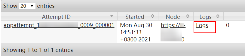

  2. Click the application ID of the failed job to go to the job page.

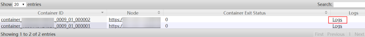

    1. Click Logs in the Logs column to view JobManager logs.
      Figure 2 Clicking Logs
    2. Click the ID in the Attempt ID column and click Logs in the Logs column to view and save TaskManager logs.
