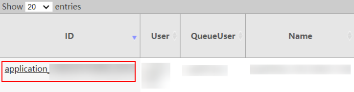

- Locate the abnormal task based on its name displayed in Location, search for and record the application ID of the job, and check whether the job logs are available on the Yarn page.
Figure 1 Application ID of a job

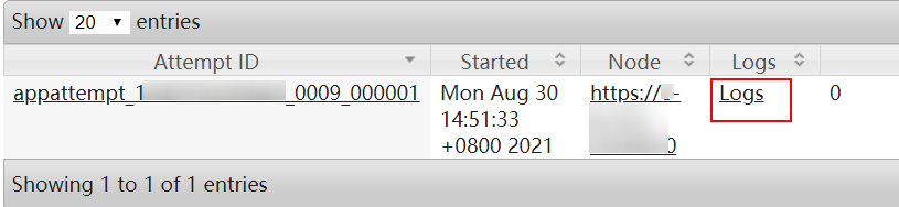

- Click Logs in the Logs column to view JobManager logs.
Figure 2 Clicking Logs

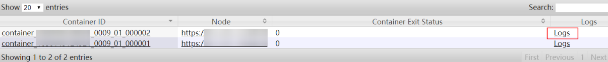

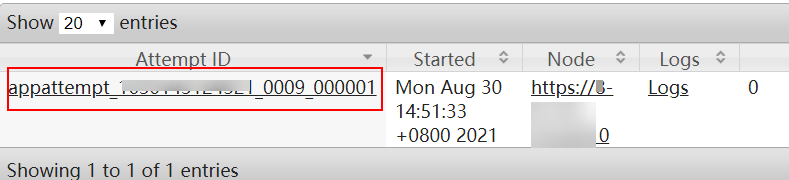

- Click the ID in the Attempt ID column and click Logs in the Logs column to view and save TaskManager logs. Then go to Step 7.
Figure 3 Clicking the ID in the Attempt ID columnFigure 4 Clicking Logs
