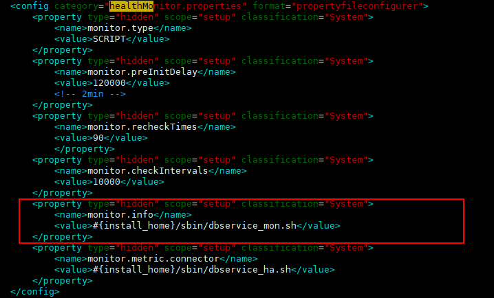

  7. Log in to the active OMS node as user root and run the following command to view the configurations.xml file. In the preceding command, "Service name" is the service name queried in Step 1.
    vi $BIGDATA_HOME/components/current/Service name/configurations.xml
    Search for the keyword healthMonitor.properties, find the health check configuration item corresponding to the alarm reporting instance, and record the interface or script path specified by monitor.info, as shown in the following figure.
    Check the logs recorded in the interface or script and rectify the fault.

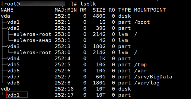

  9. Check whether the required disk is mounted on the faulty node normally.
    1. Log in to the node where the alarm was generated as the root user and run the following command to check whether there is a disk whose TYPE is part and MOUNTPOINT is empty.
      lsblk
      • If yes, the disk is not mounted. Go to 9.b.
      • If no, the disk is mounted. Go to Step 11.
      If information similar to the following is displayed, disk vdb1 is not mounted.
    2. Initialize the disk that fails to be mounted and mount it again. For details, see Extending Disk Partitions and File Systems.

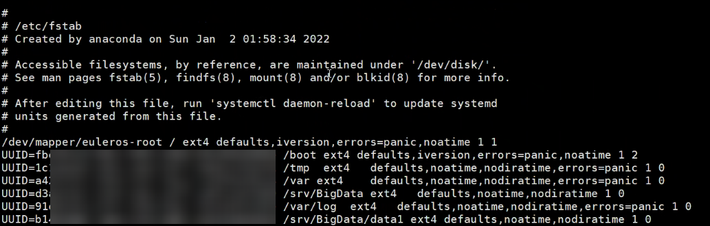

    3. Log in to the node for which the alarm was generated as the root user and run the following command to check and record the UUID of the mounted disk:
      blkid
    4. Run the following command to check whether there is the UUID of the mounted disk:
      vi /etc/fstab
      • If yes, go to 9.f.
      • If no, go to 9.e.
      The command output is shown in the following figure.
    5. Add the mounted disk information to the /etc/fstab file. You can obtain the information in any of the following ways:
      • On the node where the alarm was generated, run the following command to view historical snapshot files and check the mounting information of the offline disk:
        cat /usr/local/diskmgt/ini/fstab.xxx
      • Obtain mounting information from the /etc/fstab file on a normal node in the current cluster.
      • Contact O&M personnel.
