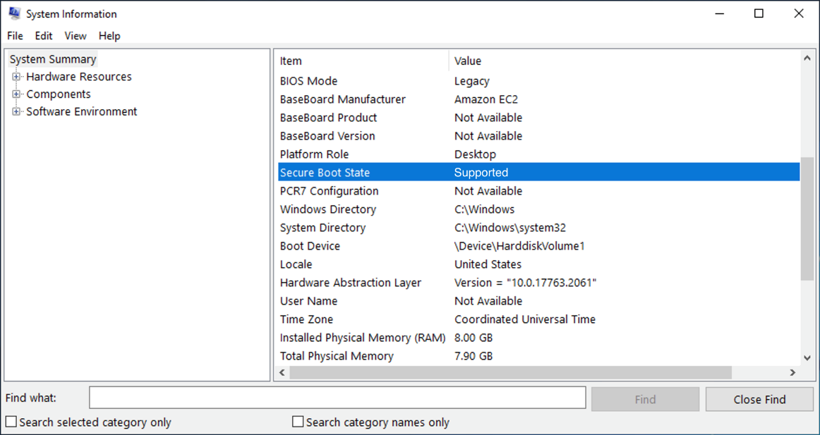

  • (Windows) Check whether UEFI secure boot is enabled.
    1. Open the msinfo32 tool.
    2. Check the Secure Boot State field.
      If the value of Secure Boot State is Supported, UEFI secure boot is enabled.
