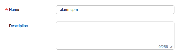

  6. Configure basic information of the alarm rule.
    Figure 1 Alarm rule information
    Table 1 Basic parameters for alarm rules
    Parameter
    Description
    Example Value
    Name
    Name of the alarm rule. The system generates a random name, and you can change it as needed.
    alarm-cprn
    Description
    Description of the alarm rule. This parameter is optional.

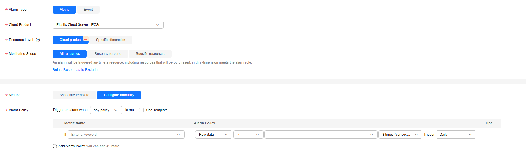

  7. Select an object to be monitored and configure alarm parameters.
    • If you select Metric for Alarm Type, you can create an alarm rule for ECS metrics.
      Figure 2 Metric alarm configuration
      Key parameters are described below. For details, see Creating an Alarm Rule and Notifications.
      • Alarm Type: The type of the alarm that the alarm rule applies to. You can select Metric or Event.
      • Cloud Product: The cloud product you want to monitor. This parameter is only available if you select Metric for Alarm Type. Example: Elastic Cloud Server - ECSs
      • Resource Level: Select the resource level of the monitored object. You are advised to select Specific dimension and then select different dimensions such as disk, mount point, and process from the drop-down list based on service requirements.
        To create an alarm rule for a GPU-accelerated ECS, select ECSs - GPU for Specific dimension.
      • Monitoring Scope: The scope that the alarm rule applies to. You can select All resources, Resource groups, or Specific resources.
      • Method: Select Associate template or Configure manually.
        After an associated template is modified, the policies contained in this alarm rule to be created will be modified accordingly.
      • Alarm Policy: The policy for triggering an alarm.

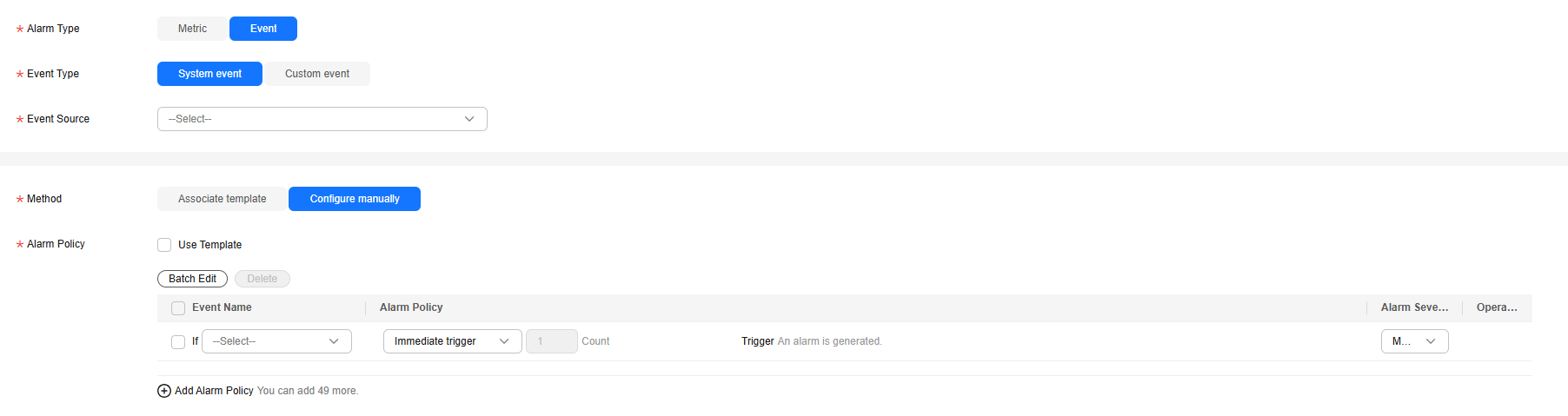

    • If you select Event for Alarm Type, you can create an alarm rule for ECS events.
      Figure 3 Event alarm configuration
      • Event Type: You can select System event or Custom event.
      • Event Source: Select the name of the cloud service from which events are reported.
