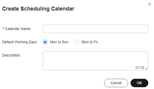

- Click Add. The Create Scheduling Calendar dialog box is displayed.
Figure 1 Create Scheduling Calendar dialog box
- Set parameters for the scheduling calendar.
Set Calendar Name, Default Working Days, and Description.
You can select Mon to Fri or Mon to Sun for Default Working Days. By default, Mon to Fri is selected.
- Click OK.

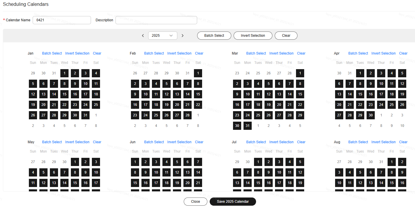

More Operations
- Modify: Click Modify in the Operation column.
- Batch Select: Select Monday to Friday throughout the current month.
- Invert Selection: Select all non-working days.
- Clear: Clear selected working days.
