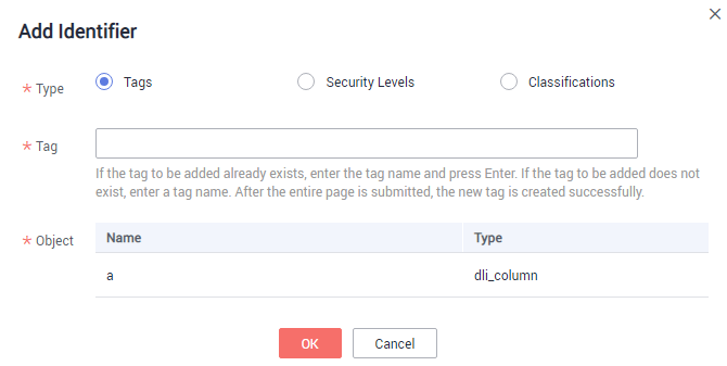

- Select the technical asset that you want to add a tag to and click Add Identifier in the upper right corner. In the Add Identifier dialog box, select Tags for Type. Figure 1 Adding an identifier
- Set the parameters and click OK.
You can add a new tag or select an existing tag. Existing tags are created by following instructions in Managing a Tag.
