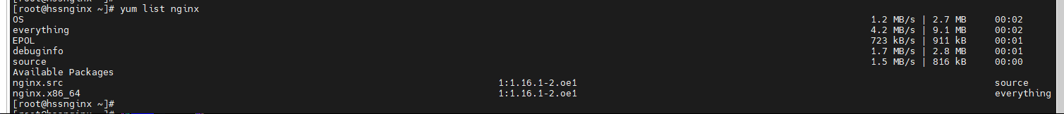

Remotely log in to the proxy server and run the following command to check whether the Nginx package exists in the Yum repository:
- For EulerOS, CentOS and Red Hat, or other OSs that support RPM installation, run the yum list nginx command.

If the information shown in The Nginx package exists (rpm) or The Nginx package exists (deb) is displayed, the Nginx package exists. - Installing Nginx

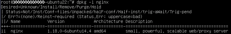

- For OSs that support DEB installation, such as Ubuntu and Debian:
Run the pkg –l nginx command. If the command output shown in Nginx installed successfully (deb) is displayed, the installation is successful.
