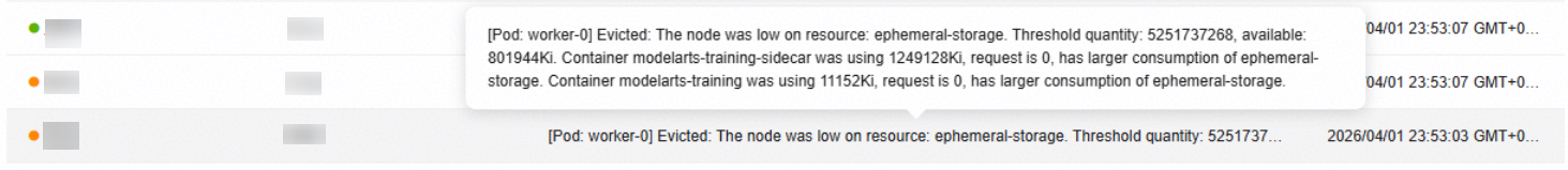

    Currently, unconditional job-level rescheduling cannot be triggered when a job is evicted. In this case, the job status changes to Failed. You are advised to first check for software code issues.
