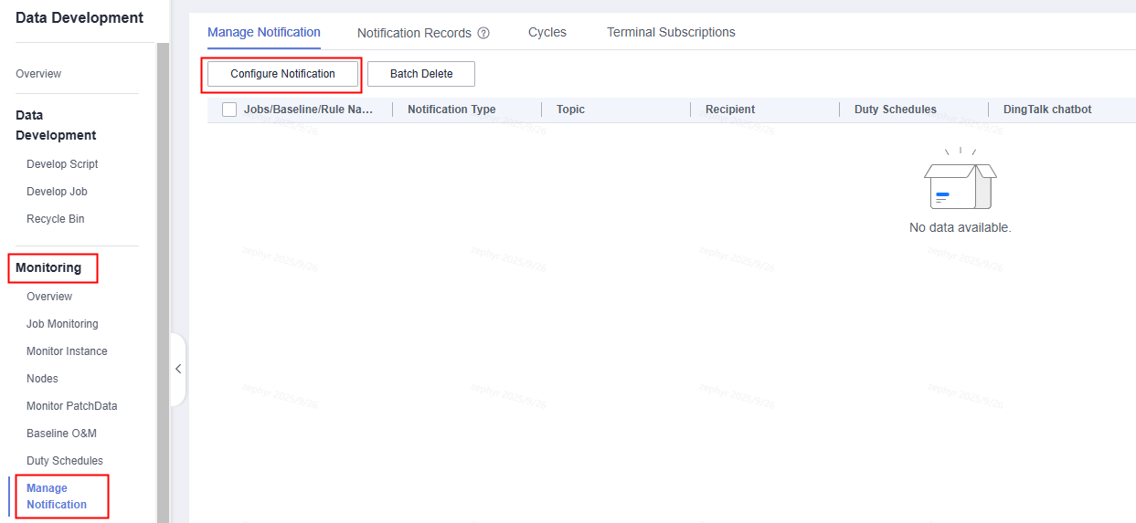

- Log in to the DataArts Studio console by following the instructions in Accessing the DataArts Studio Instance Console.
- On the DataArts Studio console, locate a workspace and click DataArts Factory.
- In the navigation pane on the DataArts Factory page, choose .
- On the Manage Notification page, click Configure Notification. Figure 1 Configuring a notification
- Set parameters. Figure 2 Setting notification parameters
- Notification Scope: Select Multiple jobs.
- Notification Type: Select Abnormal.
- Notification Mode: Select By topic.
You can receive job failure alarms by SMS message, email, or voice notification through SMN topics.
For details about how to create and subscribe to an SMN topic, see Creating a Topic and Adding a Subscription to a Topic.
- Set other parameters as required.
- Click OK. You can view the created rule on the Manage Notification page. Figure 3 Created rule
When the job status changes from Running to Abnormal or Failed, the alarm information is sent to the communications software associated with the specified topic.

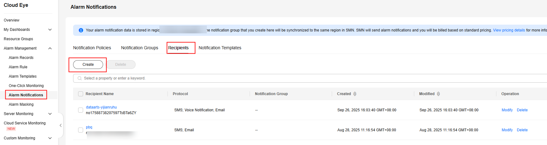

- Create a notification object and group in sequence on the Cloud Eye console.
- Create a notification object.
On the Cloud Eye console, choose Alarm Management > Alarm Notifications. On the displayed page, click the Recipients tab and click Create. On the displayed page, enter a recipient name and select a protocol.
Figure 4 Creating a notification recipient
Figure 5 Setting recipient parameters
The created recipient is displayed on the Recipients page.
Figure 6 Viewing the created notification recipient

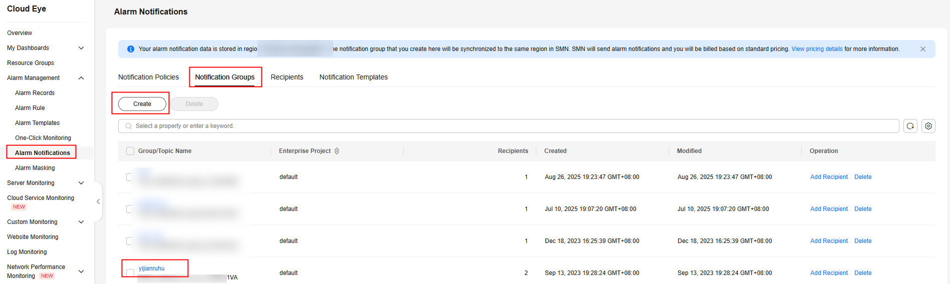

- Create a notification group and bind it to the notification recipient.
Click the Notification Groups tab and then Create. On the displayed page, enter a group name and select notification recipients.
Figure 7 Creating a notification group
The created notification group is displayed on the Notification Groups page.

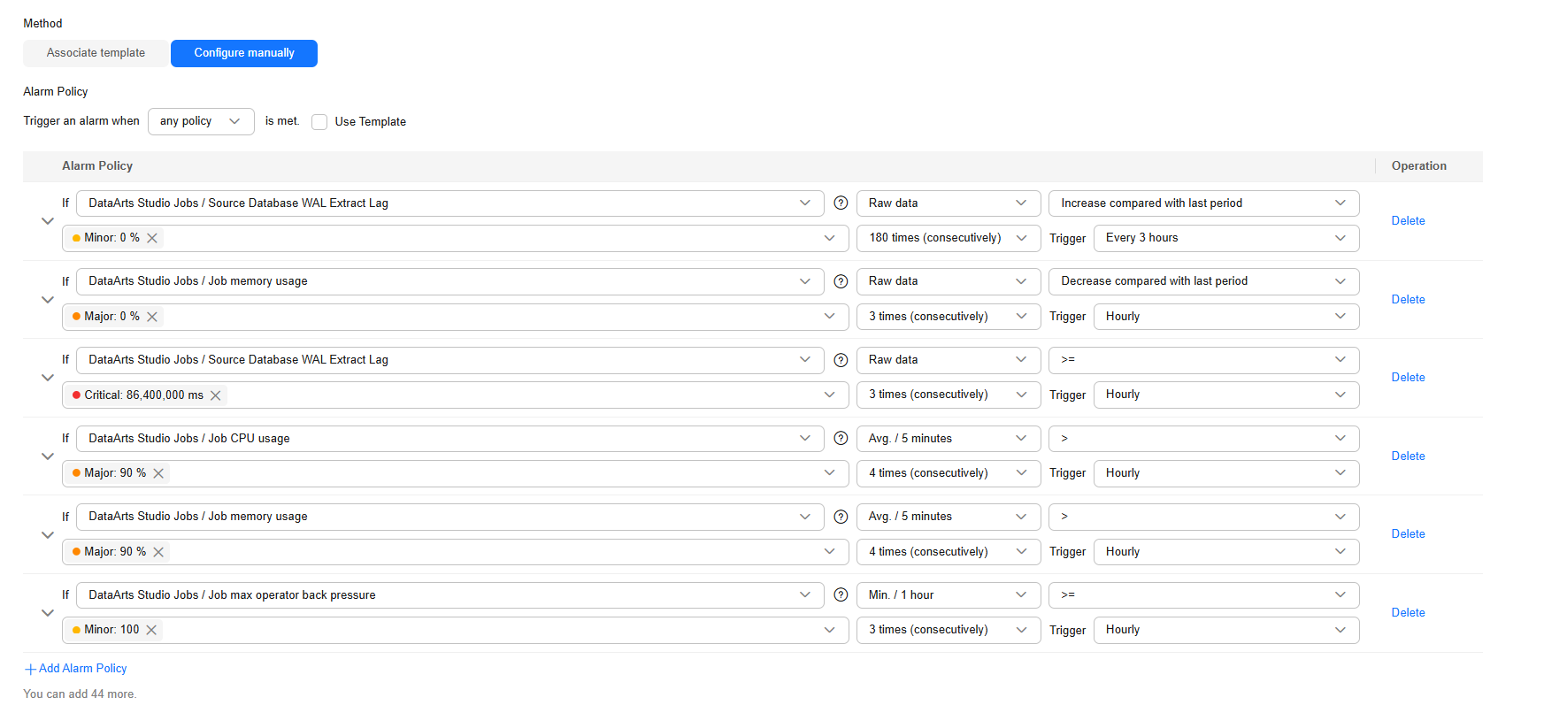

- Method: Select Associate template or Configure manually. The following table lists the common alarm rules recommended for real-time data migration jobs.
Table 1 Alarm triggering rules Category
Name
Level
Description
Abnormal job termination
Source Database WAL Extract Lag
Minor
If the original value increases by 0% for 180 consecutive periods, an alarm is triggered.
Frequency: An alarm is triggered every three hours.
Job memory usage
Major
If the original value decreases by 0% for 90 consecutive periods, an alarm is triggered.
Frequency: An alarm is triggered every hour.
Continuous job latency increase
Critical
If the original value is greater than or equal to 86,400,000 ms for three consecutive periods, an alarm is triggered.
Frequency: An alarm is triggered every one hour.
High job backpressure
Job memory usage in five minutes
Major
If the average value is greater than 90% for four consecutive periods, an alarm is triggered.
Job CPU usage in 5 minutes
Major
Job max operator backpressure in 1 hour
Minor
If the minimum value is greater than or equal to 100 for two consecutive periods, an alarm is triggered.
Unstable network

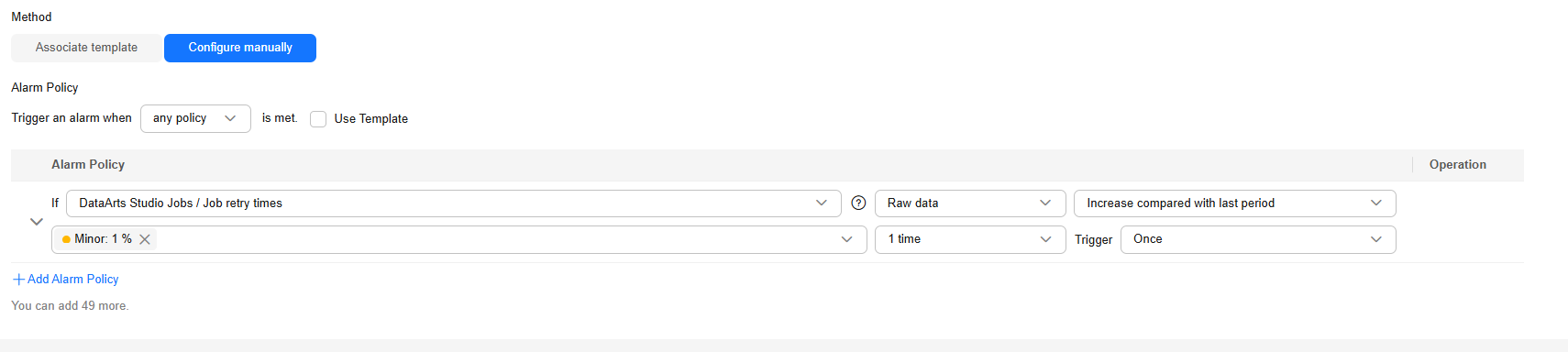

NOTE:You are advised to configure alarm rules separately for automatic job retries caused by network jitter and data source cluster pressure.
Job retries
Major
If the original value increases by 1% in one period, an alarm is triggered.
Frequency: The alarm is triggered only once.
Figure 10 Configuration of common alarm rules
Figure 11 Configuring an alarm rule for job retries
