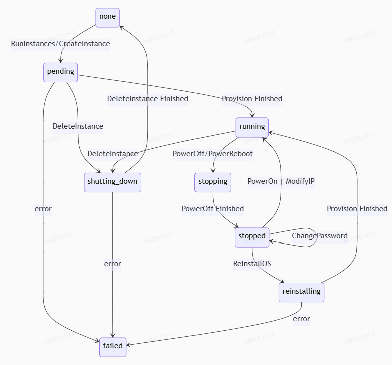

instance_state
No
String
Definition
Instance status.
Constraints
N/A
Range
  • pending: The instance is being started (resources are being allocated or the OS is being started).
  • running: The instance is running properly (can be connected through SSH or RDP).
  • stopping: The instance is being stopped (transiting to the stopped or hibernated state).
  • stopped: The instance is completely stopped (storage volumes are retained).
  • reinstalling: The OS is being reinstalled.
  • shutting-down: The instance is being terminated (being deleted).
  • terminated: The instance has been terminated (all resources are deleted and cannot be restored).
  • failed: The instance is in the failed state. You can only try to reinstall the OS. Other operations are not supported and related resources are cleared.
Default Value
N/A

state
String
Definition
Instance status.
Constraints
N/A
Range
Default Value
N/A

    "state" : "terminated",
    "user_data" : "",
    "server_id" : "0195f996-79c5-7d34-a98e-3a96f7926d96",
    "created_at" : "",
    "updated_at" : "2025-07-11T17:07:05+08:00",
    "launched_at" : "2025-04-03T10:59:03+08:00",
    "error" : {
      "error_code" : "iMetal.0099",
      "error_msg" : "failed to reinstall os, create reinstall job on Jarvis failed",
      "error_type" : "reinstall_error"
  "page_info" : {
    "next_marker" : "01981672-2e82-7d8a-a315-3f686155a815",
    "previous_marker" : "",
    "current_count" : 92
  "count" : 92
