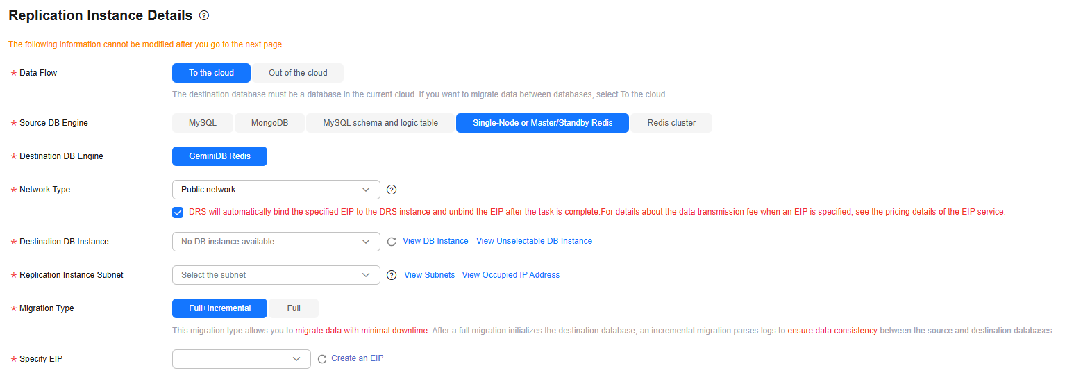

    • Replication instance information
      Figure 2 Replication instance information
      Table 5 Replication instance settings
      Parameter
      Description
      Data Flow
      Select To the cloud.
      The destination database must be a database on the current cloud.
      Source DB Engine
      Select Single-Node or Master/Standby Redis.
      Destination DB Engine
      Select GeminiDB Redis.
      Network Type
      Available options: VPC, VPN or Direct Connect, and Public network. Public network is selected in this example.
      • VPC is suitable for migrations between cloud databases of the same account in the same region and VPC.
      • Public network is suitable for migrations from on-premises databases or external cloud databases to destination databases.
      • VPN or Direct Connect is suitable for migrations from on-premises databases to cloud databases or between databases across regions on the cloud using a VPN, Direct Connect, Cloud Connect, VPCEP, or a VPC peering connection.
      Destination DB Instance
      Select the DB instance you created.
      Replication Instance Subnet
      The subnet where the replication instance resides. You can also click View Subnets to go to the network console to view the subnet where the instance resides.
      By default, the DRS instance and the destination DB instance are in the same subnet. You need to select the subnet where the DRS instance resides, and there are available IP addresses for the subnet. To ensure that the replication instance is successfully created, only subnets with DHCP enabled are displayed.
      Migration Type
      • Full: This migration type is suitable for scenarios where service interruption is permitted. It migrates all objects and data in non-system databases to the destination database at one time. The objects include collections, views, and indexes.
        NOTE:
        If you are performing a full migration, do not perform operations on the source database. Otherwise, data generated in the source database during the migration will not be synchronized to the destination database.
      • Full+Incremental: This migration type allows you to migrate data without interrupting services. After a full migration initializes the destination database, an incremental migration initiates and parses logs to ensure data consistency between the source and destination databases.
        NOTE:
        If you select Full+Incremental, data generated during the full migration will be continuously synchronized to the destination database, and the source remains accessible.
      Specify EIP
      This parameter is available when you select Public network for Network Type. Select an EIP to be bound to the DRS instance. DRS will automatically bind the specified EIP to the DRS instance and unbind the EIP after the task is complete. The number of specified EIPs must be the consistent with that of DB instances.
      For details about the data transfer fee generated using a public network, see EIP Price Calculator.

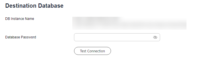

    • Destination database configuration
      Figure 7 Destination database information
      Table 10 Destination database settings
      Parameter
      Description
      DB Instance Name
      The DB instance you selected when creating the migration task. This parameter cannot be changed.
      Database Password
      The password for the database username.
      The password of the destination database is encrypted and stored in the database and the replication instance during the migration. After the task is deleted, the password is permanently deleted.

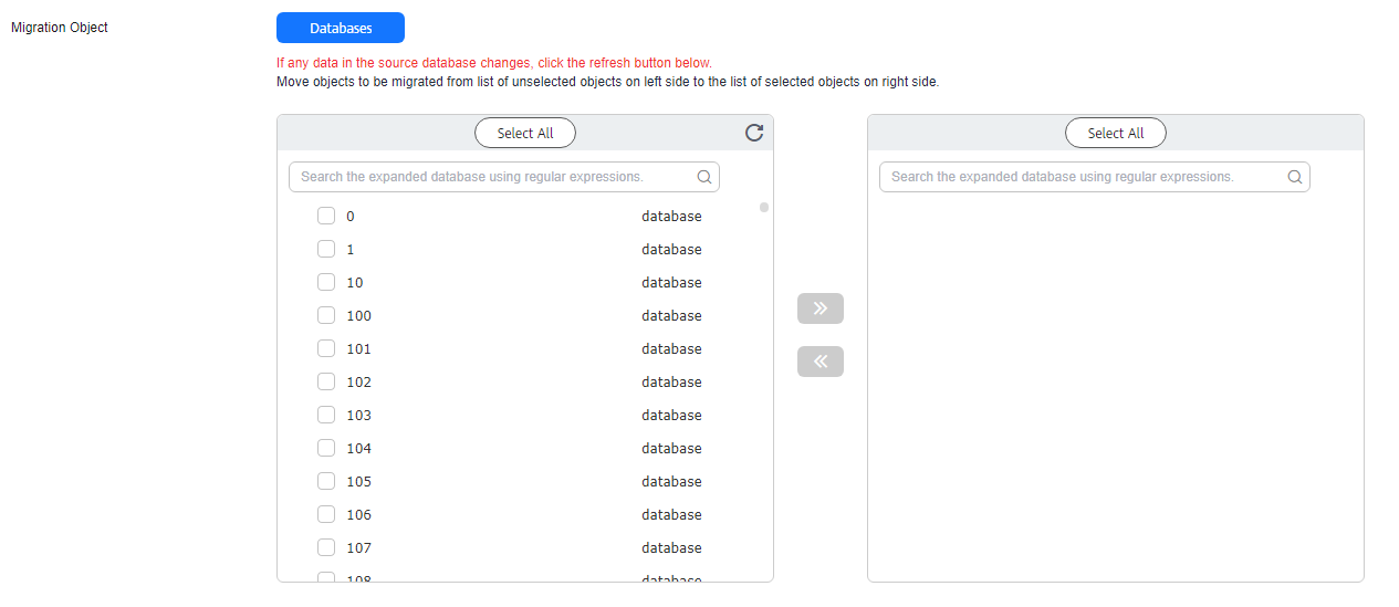

  4. On the Set Task page, select migration objects and click Next.
    Figure 8 Migration object
    Table 11 Migration object
    Parameter
    Description
    Migrate Object
    The left pane displays the source database objects, and the right pane displays the selected objects. DRS supports database-level migration. You can select the databases to be migrated based on service requirements.
    If the source database is changed, click in the upper right corner before selecting migration objects to ensure that the objects to be selected are from the changed source database.
    NOTE:
    • If you choose not to migrate all of the databases, the migration may fail because the objects, such as stored procedures and views, in the databases to be migrated may have dependencies on other objects that are not migrated. To prevent migration failure, migrate all of the databases.
    • If an object name contains spaces, the spaces before and after the object name are not displayed. If there are two or more consecutive spaces in the middle of the object name, only one space is displayed.
    • The name of the selected migration object cannot contain spaces.
    • To quickly select the desired database objects, you can use the search function.
