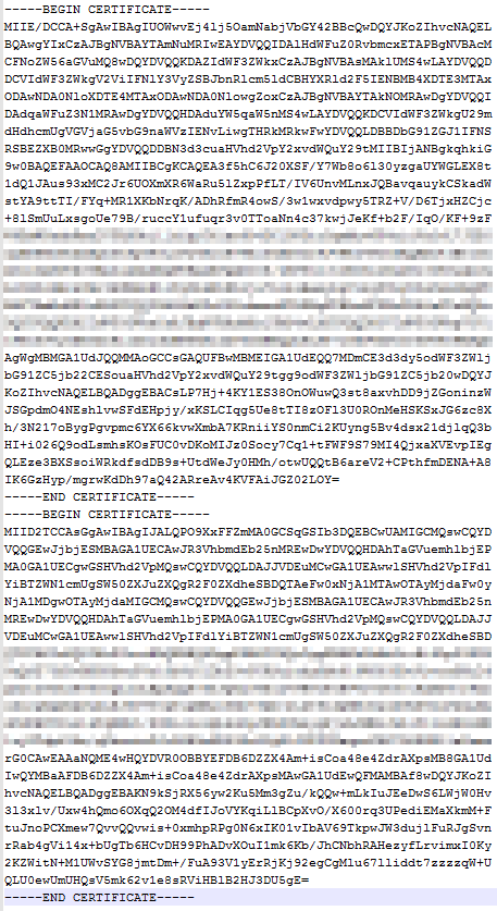

Use the text program to open the certificate in the PEM format, then you can view the certificate content, as shown in Figure 1.
A certificate in PEM format
- The certificate starts with the -----BEGIN CERTIFICATE----- chain and ends with the -----END CERTIFICATE----- chain.
- Each line of the certificate content contains 64 characters, but the number of characters in the last line can be smaller than 64.
- No space is allowed in the certificate content.
Certificates Issued by Intermediate CAs
The certificate file issued by an intermediate agency contains several certificates. You need to combine the certificates into an integral one, and upload it when configuring HTTPS security acceleration. A combined certificate is shown as Figure 2.

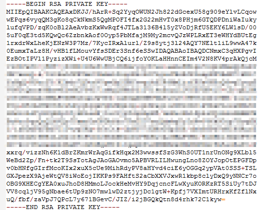

Use the text program to open the private key file in the PEM or KEY format, then you can view the private key content, as shown in Figure 3.
Content of an RSA private key:
- The private key starts with the -----BEGIN RSA PRIVATE KEY----- chain and ends with the -----END RSA PRIVATE KEY----- chain.
- Each line of the private key content contains 64 characters, but the number of characters in the last line can be smaller than 64.
- No space is allowed in the private key content.
If the certificate chain of a private key file contains the following information: -----BEGIN PRIVATE KEY----- and -----END PRIVATE KEY-----, or -----BEGIN ENCRYPTED PRIVATE KEY----- and -----END ENCRYPTED PRIVATE KEY-----, you need to use the OpenSSL tool to run the following command to convert the format.
