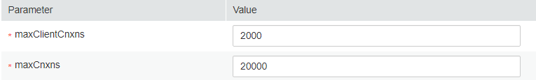

- On the FusionInsight Manager portal, choose Cluster > Name of the desired cluster > Services > ZooKeeper > Configurations > All Configurations > quorumpeer > Performance and increase the value of maxCnxns as required. Figure 1 maxCnxns
- Save the configuration and restart the ZooKeeper service.
