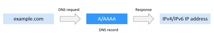

- Routing Internet traffic to a website
A and AAAA record sets are usually used to map domain names used by websites to IPv4 or IPv6 addresses of web servers where the websites are deployed.
Figure 1 Accessing a website over the Internet using domain name - Private domain name resolution

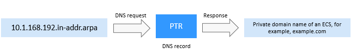

Figure 3 Email domain name resolution - Reverse resolution on a private network
PTR records translate private IP addresses into private domain names.
Figure 4 Reverse resolution on a private network
