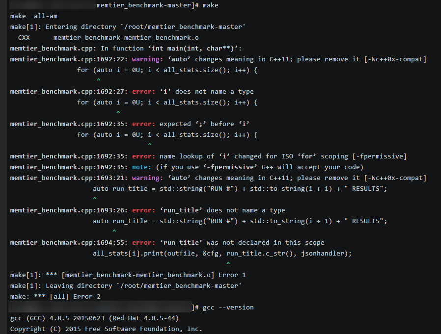

        If the following error information is displayed during the download of the memtier_benchmark source code, run the git clone https://github.com/RedisLabs/memtier_benchmark.git -b 1.4.0 command to install another branch.
