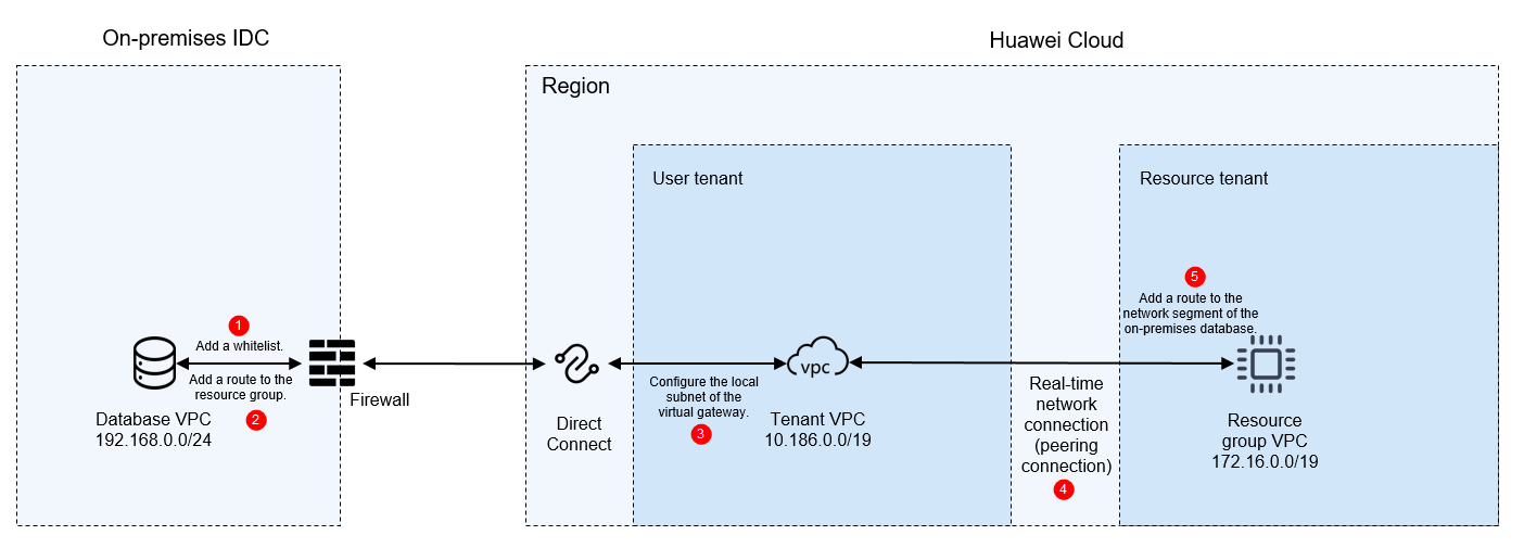

Network Configuration Process
- Configure a whitelist for the databases of the on-premises IDC.
Allow the VPC network segment (for example, 172.16.0.0/19) of the migration resource group to access the databases of the on-premises IDC. The method of configuring a whitelist varies depending on the database type. For details, see the official documentation of each database.
The ports used by different data sources vary. Configure the ports for security group rules by referring to Which Ports Must Be Allowed by the Data Source Security Group So That DataArts Migration Can Access the Data Source?
- (Optional) Add a route for the on-premises IDC.
Add a route for the on-premises IDC to the VPC network segment (for example, 172.16.0.0/19) of the migration resource group and Huawei gateway. For details about how to add a route, see Configuring Routes.
- Add the migration resource group network segment to the local subnet of the Direct Connect connection.
To allow Direct Connect to access the migration resource group network segment, perform the following operations: Log in to the Direct Connect console. In the navigation pane on the left, choose Direct Connect > Virtual Gateways. In the list, locate the virtual gateway used for connecting to the on-premises IDC and click Modify in the Operation column. In the displayed dialog box, enter the VPC network segment (for example, 172.16.0.0/19) of the migration resource group for Local Subnet.
Figure 4 Adding a local subnet - Create a real-time network connection (VPC peering connection) for migration.
To connect the tenant VPC to the real-time migration resource group VPC, you can create a VPC peering connection between the two VPCs using the resource management function provided of DataArts Studio.

- Add a route to the data source network segment for the real-time network connection (VPC peering connection).
Locate the real-time network connection created in step 4, click More in the Operation column and select Add Route. In the displayed dialog box, enter the private network address of the database of the on-premises IDC, for example, 192.168.0.0/24.
