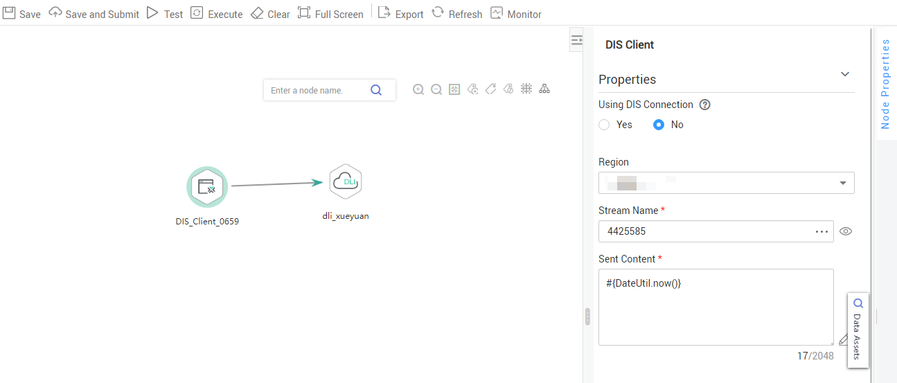

This section uses the #{DateUtil.now()} expression as an example.
- Use the DIS Client node.
- Prerequisites: A DIS stream is available.
- Method: Select the DIS Client node, write the EL expression in the data to be sent, and click Test. Then right-click the node to view the log. The value of the EL expression is printed in the log.
