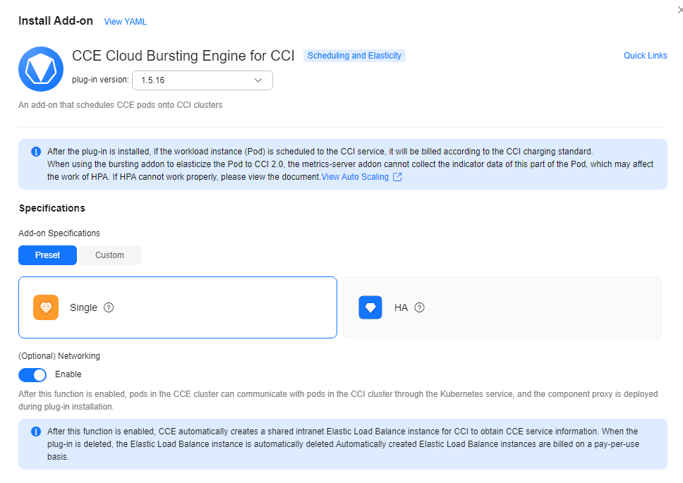

- Install the add-on and enable Networking.
- On the Network Console, view the load balancer that is automatically created in your account after the add-on installation is successful.

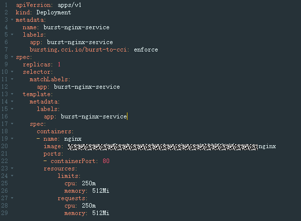

- Create a pod in CCI and configure a Service to expose the pod.
- To facilitate verification, select the nginx image that uses port 80.

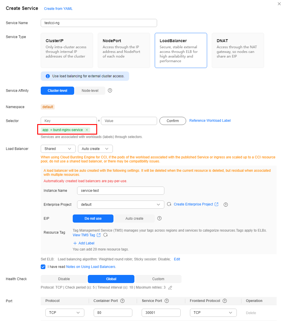

- Configure a Service that uses the same label as the workload. Select Auto create so that a load balancer can be created automatically. This avoids conflicts with the load balancer automatically created for the add-on.

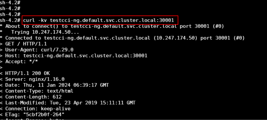

- Enter the pod in CCI, so that this pod can access the Service of the pod in CCE through <Service-name>.<namespace-name>.svc.cluster.local:port. Check whether the pod in CCI can access the pod in CCE through the Service. Figure 1 Service for accessing the pod in CCE
- Enter the pod in CCE, so that the pod can access the Service of the pod in CCI. Check whether the pod in CCE can access the pod in CCI through the Service. Figure 2 Service for accessing the pod in CCI

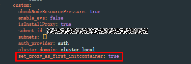

- Select the CCE Cloud Bursting Engine for CCI add-on and click Edit. Figure 3 CCE Cloud Bursting Engine for CCI
- Enable Network Connectivity and then click Edit YAML. Figure 4 Editing the add-on
- Set set_proxy_as_first_initcontainer to true. Figure 5 Modifying the parameter

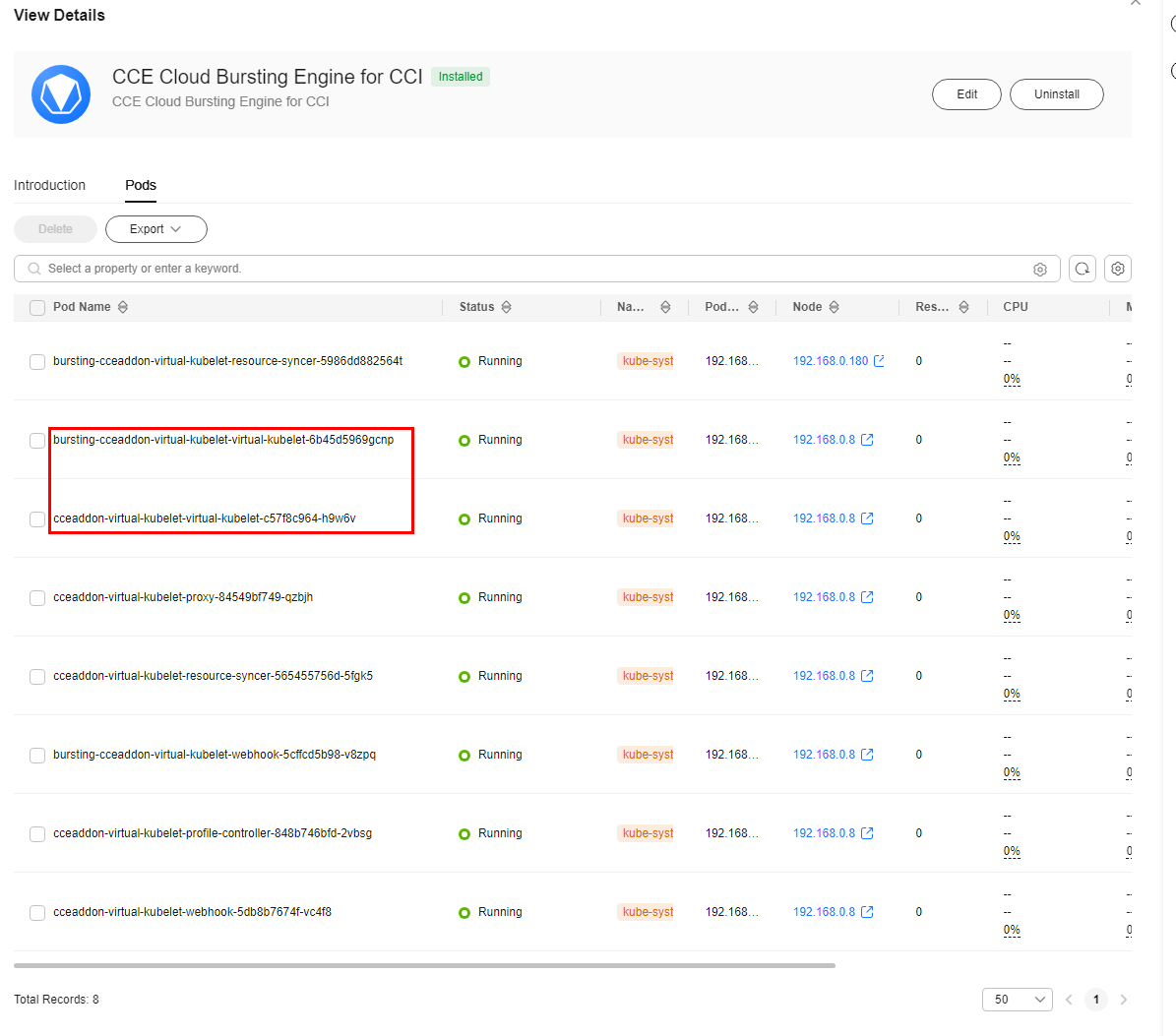

- In the instance list of the add-on, check whether the instance name is bursting-cceaddon-virtual-kubelet-virtual-kubelet-xxx and the status is Running. If yes, the deployment is complete, and networking is normal. Figure 6 Checking the add-on deployment status
