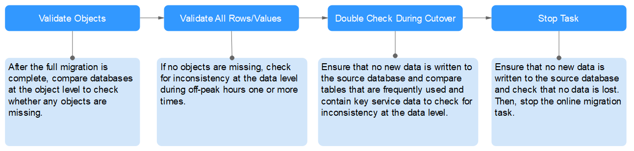

Figure 1 Migration comparison process

You can follow the comparison process or select a comparison method based on your service scenario. The following operations describe how to compare migration items by following the recommended migration process.
  1. On the Online Migration Management page, click the target migration task name in the Task Name/ID column.
  2. On the Migration Comparison tab, compare objects of the source and destination databases.
    You can also select the migration task on the Online Migration Management page and click View to go to the Migration Comparison page.
    • Create an Object-Level Comparison task to check the integrity of database objects.
      Click Object-Level Comparison. On the Object-Level Comparison tab, click Compare. Wait for a while and click , and view the comparison result of each comparison item.

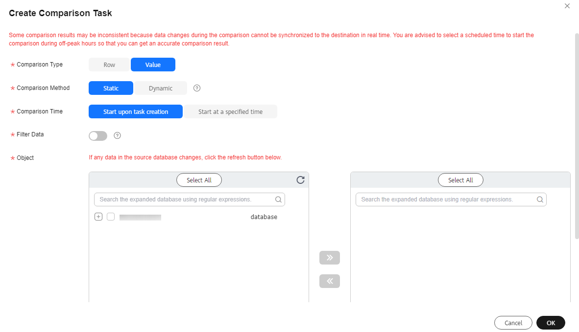

    • Create a Data-Level Comparison (row comparison or value comparison) task to compare the number of rows and values of the migrated data.
      If you only need to compare the number of rows of all migration objects, you can select a specified migration task on the Online Migration Management page and click Compare in the Operation column to create a comparison task.
      1. In the Before You Start pane, click Validate All Rows/Values.
      2. In the displayed Create Comparison Task dialog box, specify Comparison Type, Comparison Method, Comparison Time, and Object. Then, click OK.
        Figure 3 Creating a comparison task
        • Comparison Type: compares rows and values.
        • Comparison Method: DRS provides static and dynamic comparison methods.
          • Static: All data in the source and destination databases is compared. The comparison task ends as the comparison is completed. Static comparison can only be performed when there are no ongoing services.
          • Dynamic: All data in the source database is compared with that in the destination database. After the comparison task is complete, incremental data in the source and destination databases is compared in real time. A dynamic comparison can be performed when data is changing.
          • The comparison mode can only be changed for MySQL.
          • During database-level migration, tables cannot be created in the source database during dynamic comparison. If you want to create a table in the source database, cancel the dynamic comparison first. After the new table is created and migrated, restart the dynamic comparison.
        • Comparison Time: You can select Start upon task creation or Start at a specified time. There is a slight difference in time between the source and destination databases during synchronization. Data inconsistency may occur. You are advised to compare migration items during off-peak hours for more accurate results.
        • Filter Data: After this function is enabled, objects can be compared based on the configured filtering criteria.
          Only MySQL-to-MySQL migration tasks support data filtering and comparison.

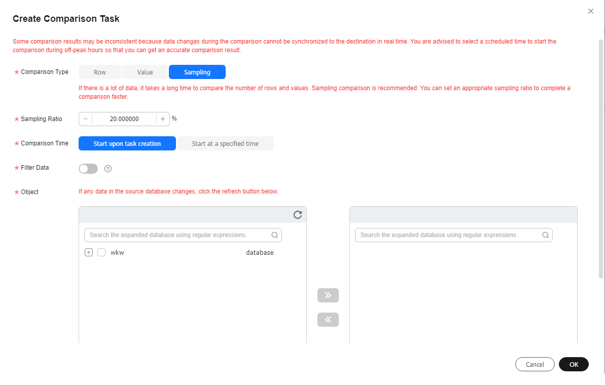

    • Create a Data-Level Comparison (sampling comparison) task. If there is a lot of data, it takes a long time to compare the number of rows and values. Sampling comparison is recommended. You can set an appropriate sampling ratio to complete a comparison faster.
      On the Data-Level Comparison page, click Create Comparison Task, select Sample for Comparison Type, set Sampling Ratio, Comparison Time, and Object, and click OK.
      • Only real-time migration tasks from MongoDB to DDS and from DDS to MongoDB support sampling comparison.
      • The $sample command provided by MongoDB is used for data sampling: {$sample: { size: <positive integer N> } }.
        In the preceding command, size is fixed to 1000. To perform MongoDB sampling comparison provided by DRS, the $sample command is executed for multiple times until the sampled data volume reaches the specified sampling ratio.
      • In a single sampling comparison task, the $sample command is executed for multiple times. In this case, the same data in the source database may be obtained for multiple times.
      • The total data volume of a collection is obtained using estimatedDocumentCount. It is an estimated value instead of an accurate value. The actual sampling data volume and sampling ratio may fluctuate, which is normal.
      • Sampling comparison does not support documents whose _id is of the BinData data type. Documents whose _id is of the BinData data type will be filtered out and not be compared.
      • If the number of inconsistent data records in a single MongoDB sampling comparison task exceeds 10,000, the comparison stops. A maximum of 10,000 inconsistent data records can be displayed.

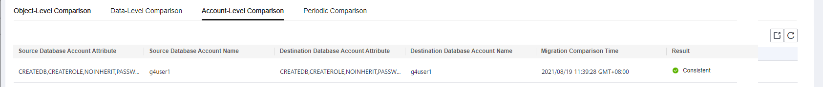

    • Create an Account-Level Comparison task to compare database accounts and permissions. Click the Account-Level Comparison tab to view the comparison results of database accounts and permissions.
      Figure 5 Account-level comparison
      • Full migration tasks do not support account-level comparisons.

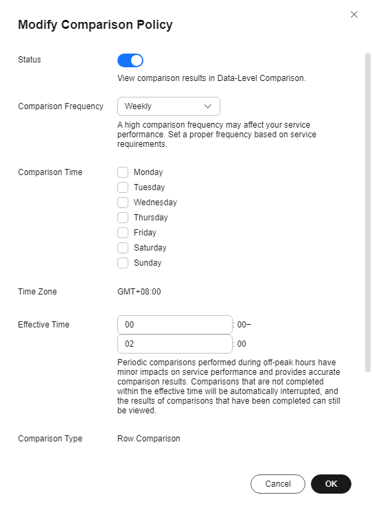

Periodic comparison indicates that DRS periodically compares the number of rows or objects in the source database table with those in the destination database table and displays the comparison results.
  2. Choose Migration Comparison.
  3. Click the Periodic Comparison tab and click Modify Comparison Policy.
    Only MySQL-to-MySQL and MySQL-to-TaurusDB migration tasks support periodic comparison.
  4. In the Modify Comparison Policy dialog box, enable periodic comparison, specify the comparison frequency, time interval, effective time and comparison type, and click Yes.
    • After periodic comparison is enabled, DRS compares the number of rows or objects at the scheduled time. You can view the comparison results on the Data-Level Comparison or Object-Level Comparison tab.
    • After periodic comparison is disabled, only historical comparison results can be viewed.
    • Modifications to the comparison policy settings take effect from the next comparison and do not affect the on-going periodic comparison tasks.
    • During periodic comparison, the source and destination databases will be read. Perform the comparison during off-peak hours.
    • During periodic comparison, ultra-large tables (those with more than 100 million rows) are automatically filtered out. You can use data-level comparison to spot check such large tables. It is not recommended that these large tables be compared periodically.
    Figure 6 Modify Comparison Policy
Quick Comparison
To accelerate and simplify the migration process, DRS provides the quick comparison function. You can directly perform a comparison on the migration task list. This function can be used to compare all migration objects only when incremental migration tasks are in progress.
  1. On the Online Migration Management page, locate the target migration task and click Compare in the Operation column.
  2. On the Create Comparison Task page, select Start upon task creation or Start at a specified time and click Yes to start the comparison task.
Viewing a Comparison Task
  1. On the Online Migration Management page, locate the target migration task and click View in the Operation column.
  2. On the Migration Comparison tab, view the data comparison result.
