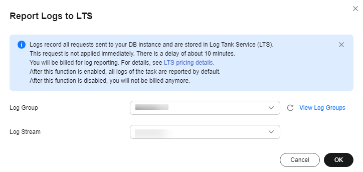

  5. On the Basic Information page, click Migration Logs on the left.
  6. Click next to Report Logs to LTS in the upper part of the page.
  7. Select an LTS log group and log stream and click OK.
    This request does not take effect immediately. There is a delay of about 10 minutes.
    Figure 1 Enabling audit log reporting to LTS

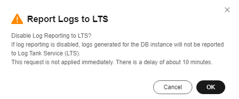

  1. To disable or modify log reporting, click the toggle switch next to Report Logs to LTS or click Edit next to the Report Logs to LTS toggle switch.
    • Modifying log reporting: Click Edit next to the Report Logs to LTS toggle switch. In the displayed dialog box, select the LTS log group and log stream again and click OK.
    • Disabling log reporting: Click the toggle switch next to Report Logs to LTS. In the displayed dialog box, click OK.
      Figure 2 Disabling log reporting to LTS
