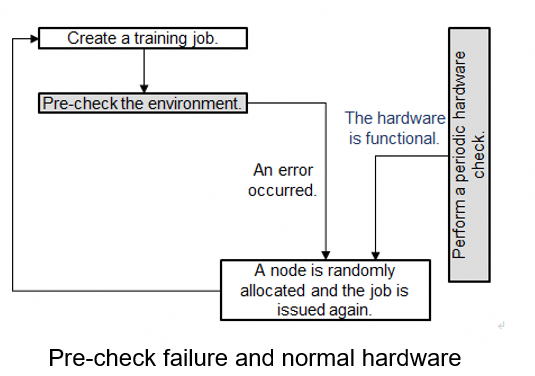

- Scenario 2: The environment pre-check fails but the hardware is functional. Then, ModelArts randomly allocates nodes and issues the training job again. Figure 2 Pre-check failure but functional hardware

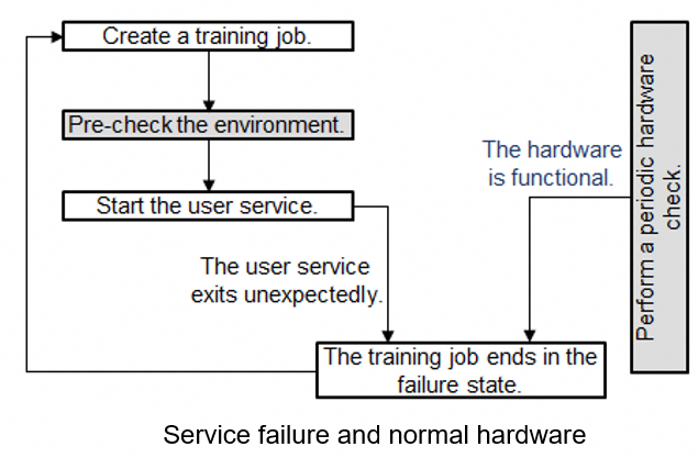

- Scenario 3: The environment pre-check is successful and the user service starts. A hardware fault occurs and the user service exits unexpectedly. Then, ModelArts automatically isolates all faulty nodes and issues the training job again. Figure 3 Service failure and hardware fault
- Scenario 4: The environment pre-check is successful and the user service starts. The hardware is functional. A fault occurs in the user service, the training job ends in the failure state. Figure 4 Service failure and functional hardware
