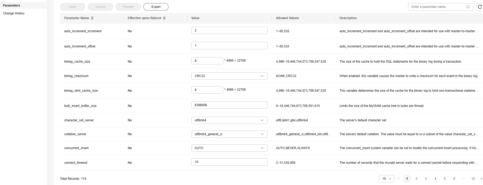

  6. On the Parameters page, modify parameters as required.
    Figure 1 Modifying parameters in a parameter template
    • To save the modifications, click Save.
    • To cancel the modifications, click Cancel.
    • To preview the modifications, click Preview.
  7. After the parameter values are modified, you can click Change History to view the details.

  5. In the navigation pane, choose Parameters. On the displayed page, modify parameters as required.
    Check the value in the Effective upon Reboot column.
    • If the value is Yes and the DB instance status on the Instances page is Parameter change. Pending reboot, a reboot is required for the modifications to take effect.
      • If you have modified parameters of a primary DB instance, you need to reboot the primary DB instance for the modifications to take effect. (For primary/standby DB instances, the parameter modifications are also applied to the standby DB instance.)
      • If you have modified parameters of a read replica, you need to reboot the read replica for the modifications to take effect.
    • If the value is No, the modifications take effect immediately.
    After parameters are modified, you can click Change History to view parameter modification details.
