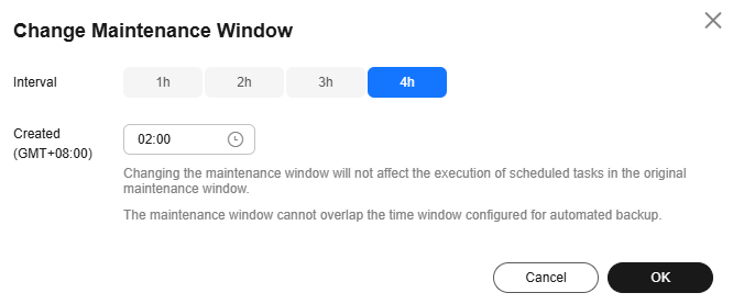

- Click
in the upper left corner and select a region and a project. - Click
in the upper left corner of the page and choose Databases > Relational Database Service. - On the Instances page, click the target instance name to go to the Overview page. Under Maintenance Window, click Configure.
- In the displayed dialog box, select an interval, select a start time from the drop-down list, and click OK.
Figure 1 Changing the maintenance window
