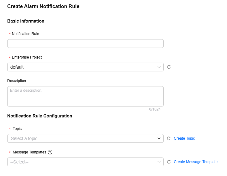

- Click Create. Set parameters such as the notification rule name and notification rule configuration. Figure 1 Creating an alarm notification rule
Table 1 Alarm notification rule parameters Parameter
Description
Notification Rule
Notification rule name, which cannot be changed after being created. Naming rules:
Use only digits, letters, underscores (_), hyphens (-), and periods (.). Do not start or end with an underscore, hyphen, or period. Up to 100 characters are allowed.
Enterprise Project
Select an enterprise project.
This parameter is displayed only when the enterprise project function is enabled for the current account.
Description
Enter a description for the rule. Up to 1,024 characters are allowed.
Enter only digits, letters, underscores (_), asterisks (*), and spaces. It cannot start or end with an underscore (_).
Rule Settings
You can select Simple or Orchestrated.- Simple: You can directly configure the notification scope. For details, see #lts_02_0926__li6262422164115.
- Orchestrated: You can configure the alarm condition and notification scope. For details, see 1.
Notification Settings
Notification settings of an alarm notification rule. When Rule Settings is set to Simple, you can directly configure the notification scope.
- Topic: SMN topic. Select your desired topic from the drop-down list.
If there is no topic you want to select, create one on the SMN console.
For details, see Creating a Topic.
- Notification Period: Select the days for sending alarm notifications.
- Effective: Alarm notifications are only sent during the configured effective period. If Effective is set to 08:00-20:00, notifications are sent only within 08:00-20:00.
- Message Templates: Notification message template. Select your desired template from the drop-down list.
If no desired message template is available, click Create Message Template on the right of the Message Templates drop-down list to create one. For details, see Creating a Message Template on the LTS Console.
- Click Add Notification Setting to add multiple notification settings. A maximum of 10 notification settings can be added.
- Click Delete to delete notification settings. At least one notification setting must be available.
